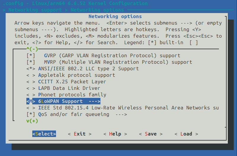

Although the Linux kernel includes a Bluetooth 6LoWPAN driver, it is disabled in the i.MX Linux BSP. Therefore, we will modify the kernel configuration to enable it.
Add 2 settings below in kernel configuration file (imx_v8_defconfig) to build the required drivers as modules:
CONFIG_6LOWPAN=m
CONFIG_BT_6LOWPAN=m
These settings can be found in the following section of the Linux kernel menuconfig.
CONFIG_6LOWPAN:
    Depends on: NET [=y] && IPV6 [=y]
Location:
-> Networking support (NET [=y])
-> Networking options
-> 6LoWPAN Support (6LOWPAN [=m])
CONFIG_6LOWPANCONFIG_6LOWPAN
 CONFIG_BT_6LOWPAN:
Depends on: NET [=y] && BT_LE [=y] && 6LOWPAN [=y]
Location:
-> Bluetooth subsystem support (BT [=y])
-> Bluetooth Low Energy (LE) features (BT_LE [=y])
-> Bluetooth 6LoWPAN support (BT_6LOWPAN [=m])
Rebuild the image containing the Linux kernel and make sure that the required drivers are present in the following paths.
