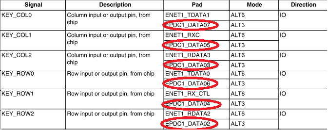

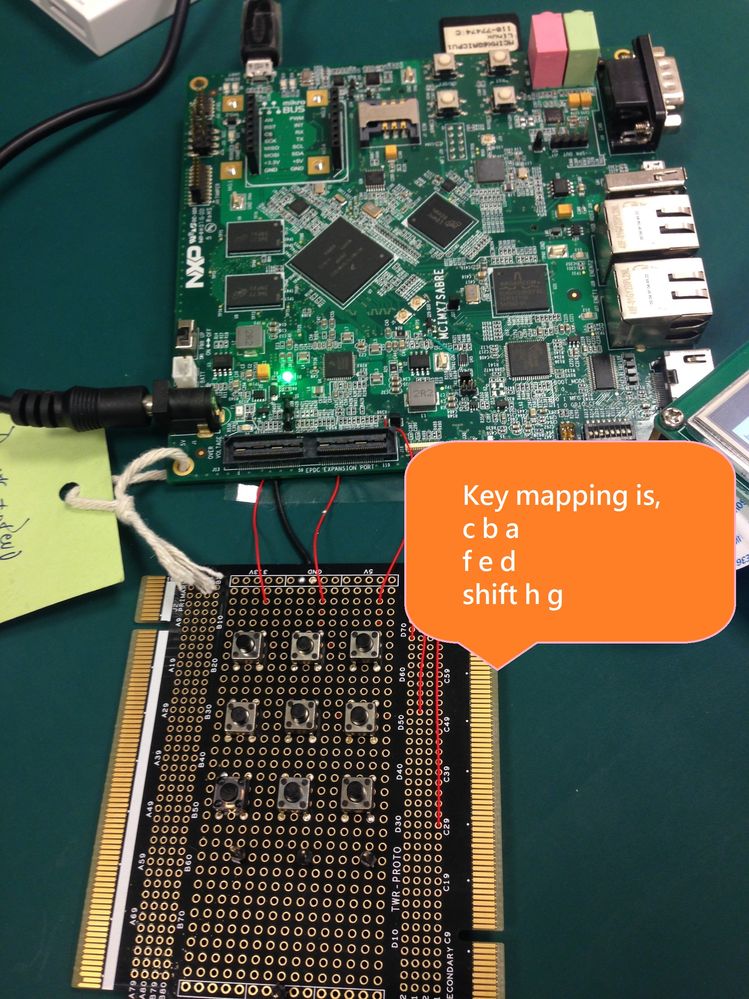

There is KPP module on i.MX7, but NXP reference board didn't have it. We reworked a "keypad" and has the demo.
Signal:

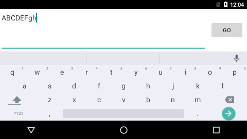

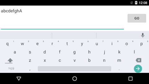

For testing, launch an app in Android that can accept text input. KPP also supports multiple input, the "A" is showed by pressing "shift" + "a".

Hi ko-hey‌,
The test result is shown as below, multiple key can be detected if it's not on the same row.
Hi JayTu
Thank you for testing.
Unfortunately, my customer need multiple key detect on the same row.
The conclusion is i.MX7 can't detect multiple key on the same row.
Am I correct ?
Ko-hey
I think it is a bug but not limitation. You can submit another ticket for it.

Attach the patch for fixing multiple key detection on the same row, 0001-Keypad-support-key-detection-at-the-same-row-on-i.MX.patch
Hi JayTu
Thank you for providing the patch.
I want to test the patch but unfortunately, I don't have any environment for test.
So could you test the pressing "shift" + " f " and "shift" + " g " again ?
If yes, could you show me it in image like above ?
Ko-hey
Hi ko-hey‌,
I've tested all the keys, it works correctly.
