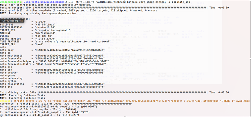

# DISTRO=fsl-imx-fb MACHINE=imx7dsabresd bitbake core-image-minimal -c populate_sdk

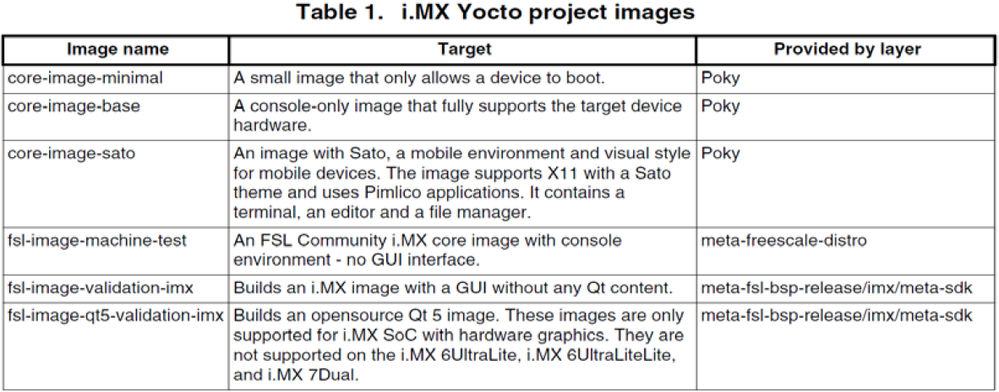

bitbake rootfs type
  •       core-image-minimal
  •       core-image-base
  •       core-image-sato
  •       fsl-image-machine-test
  •       fsl-image-validation-imx
  •       fsl-image-qt5-validation-imx
Below is the detailed description for above rootfs type:

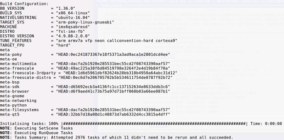

(2) Using MACHINE=imx6qsabresd to export the toolchain.
         We can change “MACHINE=imx6qsabresd” and repeat above 3 steps, environment will be named “cortex-A9”.
         Close the current terminal, and open a new one.
# cd ~/ imx-yocto-bsp
# DISTRO=fsl-imx-fb MACHINE=imx6qsabresd source fsl-setup-release.sh -b build-A9-min
         Then automatically enter “~/imx-yocto-bsp/build-A9-min”, run command below.
# DISTRO=fsl-imx-fb MACHINE=imx6qsabresd bitbake core-image-minimal -c populate_sdk

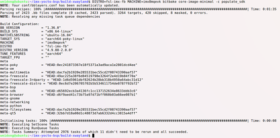

(3) Using MACHINE=imx8mqevk to export ARM64 toolchain
         Export Toolchain for i.MX8MQ, create a new terminal, then run these 2 commands below.
# ~/imx-yocto-bsp
# DISTRO=fsl-imx-xwayland MACHINE=imx8mqevk source fsl-setup-release.sh -b build-xwayland
# DISTRO=fsl-imx-fb MACHINE=imx8mqevk bitbake core-image-minimal -c populate_sdk
Done.

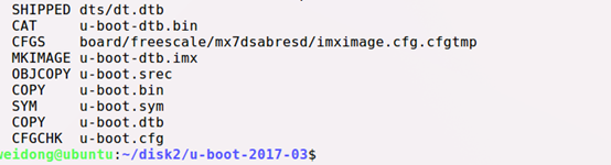

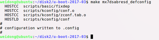

# make mx7dsabresd_defconfig
# make u-boot.imx
Done.

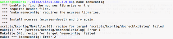

         Probably users want to run “make menuconfig”, and meet the errors like below.
# sudo apt-get install libncurses*  (To solve the problem below)
# make menuconfig

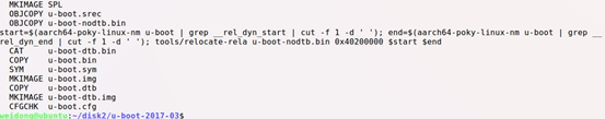

  • iMX8MQEVK

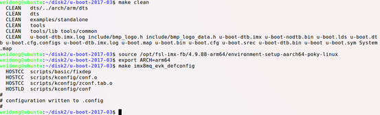

--Compiling u-boot for imx8mqevk
# cd ~/disk2/u-boot-2017-03
# source /opt/fsl-imx-fb/4.9.88-arm64/environment-setup-aarch64-poky-linux
# export ARCH=arm64
# make clean
# make imx8mq_evk_defconfig
# make u-boot.imx
Done.
