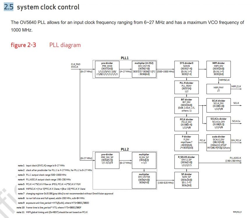

Thank you very much for a very helpful document! For item C.2, MIPI DPHY clock should match the camera sensor clock, I don't know which camera output clock mentioned here, mipi_clk, SCLK or something else.
mipi_csi2_write(info, 0x00000014, CSI2_PHY_TST_CTRL1);//ov5640 output clk
The attached diagram is for camera output clocks of OV5640. Could you suggest me which type of clock is chosen for corresponding MIPI DPHY clock
An.
MIPI DPHY clock should match the camera sensor clock, as the  sensor  output Differential clock range is from 80Mhz to 1000Mhz
If I understand that document correct you will need to use the MIPI_CLK as mipi clock, and then use the double of that (since it's DDR) as bitrate for looking up the value you need to set in CSI2_PHY_TST_CTRL1 (using the list in the document).
You will also need to set the MIPI Global timing register on the ov564x to match the PCLK.
Also, I've found that the clock from sensor must not be running when CSI2 is configured.
I've done this for OV5645 sensor (based on the Freescale OV5640 driver), I could share the code if you're interested. They should be very similar.
