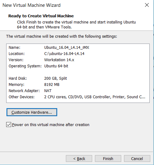

1. Create the VM in VMware Workstation.
2. Select the .iso file to install the Ubuntu 16.04 in the VM.

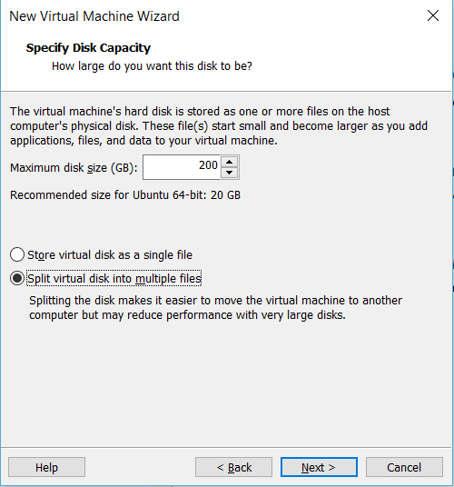

3. In "Specify Disk Capacity", I recommend the disk size is 200GB.
4. Then click "Finish" to create the VM.

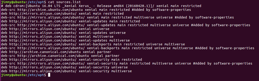

5. If you have local mirror sources, change the source in /etc/apt/source.list. This will speed up a lot when you download the Linux packages and software.
