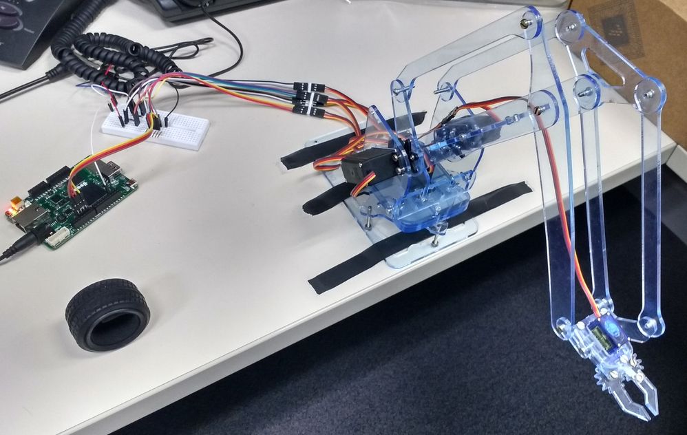

This document explains how to establish communication between the A9 core running Linux and the M4 core running an Arduino sketch on a UDOO NEO board to remotely control a robotic arm over Wi-Fi.
150249_150249.jpgIMG_20160505_093729167_HDR.jpgFigure 1: UDOO NEO board connected to the robotic arm

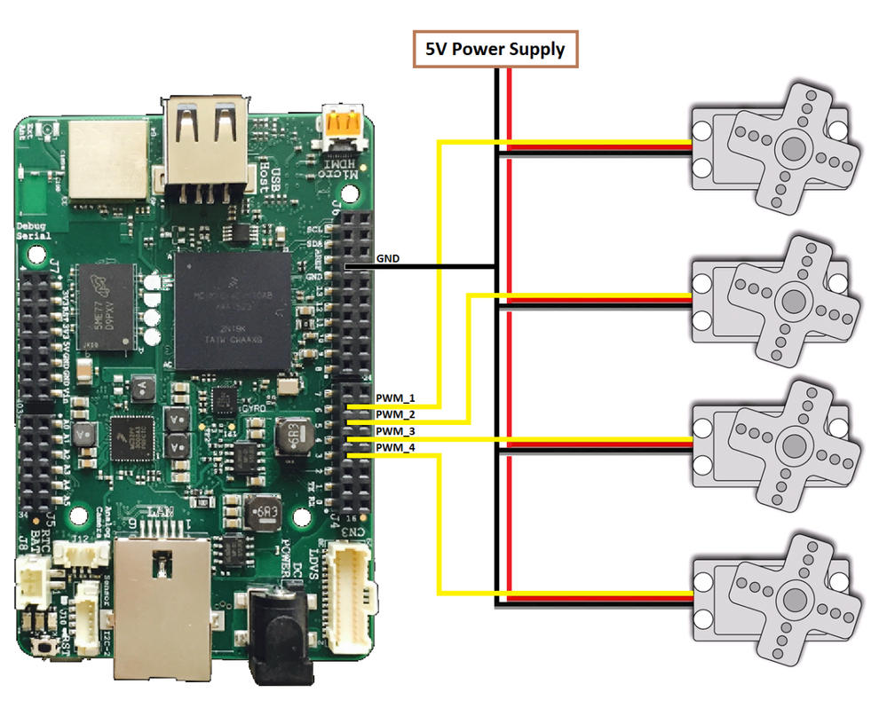

b) Then, it is required to consider the arm connection, which consists of four servomotors. Therefore, the motors must be powered by a separate power supply and controlled by four PWM signals. In this case, they will be connected to PWM_1, PWM_2, PWM_3 and PWM_4 signals of J4 connector (Arduino signals). Figure 2 shows the mentioned connection:
Figure 2: Servomotors connection to UDOO NEO board.

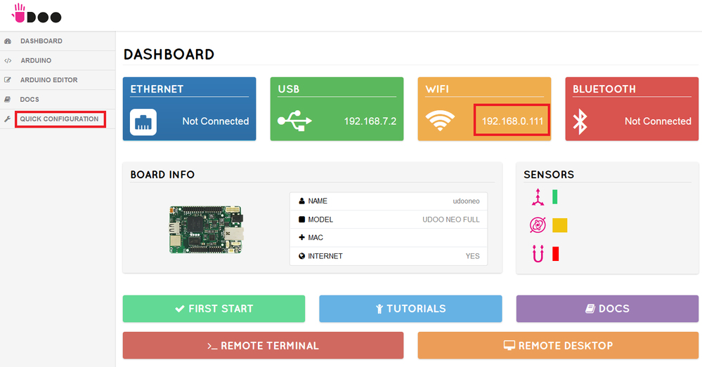

4.1 Connecting to a Wi-Fi network. After turning on the UDOO NEO board, the USB Direct connection will install a virtual NIC on the host PC, in order to access to the “Dashboard”, a configuration webpage loaded on the NEO board that could be viewed from any web browser at address 192.168.7.2. You can connect to wireless networks by using the Web Control Panel, in Configuration/Network settings.
After establishing connection with the Wi-Fi router, the Dashboard must indicate the assigned IP address of the NEO board as indicated on Figure 3. It is important to remember such address in order to establish the wireless access to the NEO board later (optionally, the NEO could be configured for a static IP address, or the router could be configure to assign the same IP address to the NEO board).
150251_150251.pngdashboard.pngFigure 3: Dashboard showing the IP address of the NEO board.
Now the USB direct connection could be removed, as the Dashboard, remote terminal and VNC server are also available over Wi-Fi using the Wi-Fi IP address.

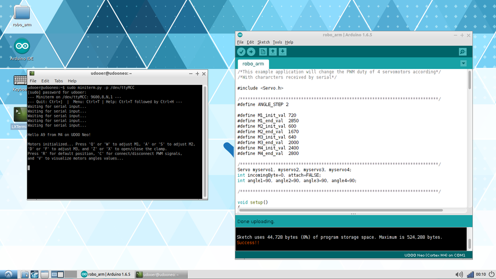

4.2. Programming the Arduino sketch. The remote desktop of the NEO could be viewed with any VNC client on the host PC, indicating the NEO’s IP address, user and password (same as SSH remote Terminal). The UDOObuntu image already include Arduino IDE configured for UDOO NEO board, so it is just required opening it to start writing the code. Figure 3 shows the UDOO NEO Desktop, which includes a Terminal window and the Arduino IDE. The sketch is available as attachment.
150252_150252.pngneo dektop.pngFigure 4: Desktop of UDOO NEO board.

  • Once the motors are initialized, each movement is defined by a key to increase and decrease the angle position of the motors, except for the clamp, which is adjusted to open/close positions.
  • Keys 'Q' and 'W' adjust the first motor; keys 'A' and 'S' adjust the second motor; keys 'D' and 'F' adjust the third motor, and finally, keys 'Z' and 'X' are used to open/close the clamp.
  • Additionally, key 'R' resets all motors to default positions; key 'C' is used to enable/disable the PWM signals, and key 'V' prints the angle values of all motors.
  • The adjust step of motors is defined with the macro “ANGLE_STEP”; the units are degrees.

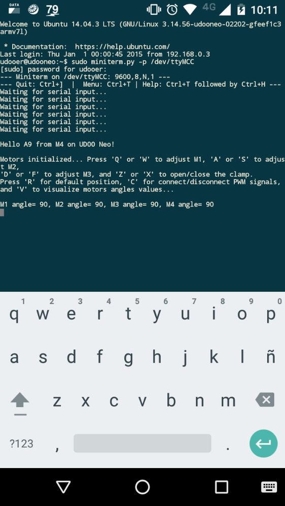

For demonstrative functionality, the UDOO NEO board running the Arduino sketch was connected to a Wi-Fi network, and it is also connected to the same network an Android phone with SSH app used to control the robotic arm. Figure 6 shows a screen capture of the mentioned app controlling the robotic arm.
150255_150255.pngScreenshot_20160505-101105.pngFigure 6: SSH app accessing to UDOO NEO.
