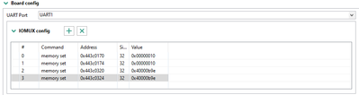

Step 2 : Setup I2C1 PinMux:
Config Tool UI:   Advance -> IOMUX config
Command:           Address                Size               Value
memory   set     0x443c0170            32                   0x10
memory   set     0x443c0174            32                   0x10
memory   set     0x443c0320            32                   0x40000b9e
memory   set     0x443c0324            32                   0x40000b9e

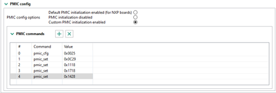

Step 3 : Set PMIC VDDQ as 1.1 V
Config Tool UI:   Advance -> Custom PMIC initialization enabled
#  PMIC commands        Value
0         pmic_cfg             0x0025       /*I2C bus 1,  PMIC address 0x25 */ (0 for I2C1, 1 for I2C2, 2 for I2C3, 3 for I2c4 …)
1         pmic_set             0x0C29       /* BUCKxOUT_DVS0/1, preset_buck1=0.8V, preset_buck2=0.7V, preset_buck3=0.8V PCA9451_BUCK123_DVS, 0x29 */
2         pmic_set             0x1118      /*  BUCK1OUT_DVS0=0.9V   PCA9451_BUCK1OUT_DVS0, 0x18 */
3         pmic_set             0x1718      /*  BUCK3OUT_DVS0=0.9V   PCA9451_BUCK3OUT_DVS0, 0x18 */
4         pmic_set             0x1428      /*  Set VDDQ to 1.1V  PCA9451_BUCK2OUT_DVS0, 0x28  */
PS : About pmic register, The first two bytes are the register address and the next two bytes are the register setting.
