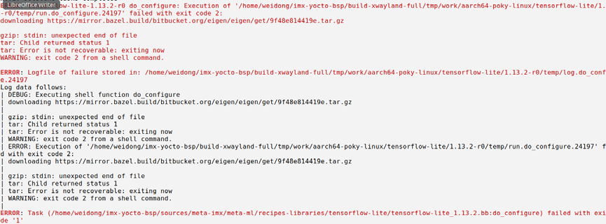

No.3 Handling tensorflow-lite compilation errors
      If you encounter a tensorflow-lite compilation error during the compilation process, the following processing methods may be helpful to you.
Cause Analysis:
         Compiling tensorflow-lite requires three steps: fetching packages, configuring environment, and compiling code.
         During the configuring environment, the following 8 software packages need to be downloaded. If any of the 8 files are not successfully downloaded, an error will be reported and compilation will be terminated.
         ①9f48e814419e.tar.gz
         ②38ebac7b059e84692f53e5938f97a9943c120d98.zip
         ③release-1.8.0.tar.gz
         ④389ec3f906f018661a5308458d623d01f96d7b23.tar.gz
         ⑤master.zip
         ⑥816a4ae622e964763ca0862d9dbd19324a1eaf45.tar.gz
         ⑦1f5eae5d6a135ff6811724f6c57f911d1f46bb15.tar.gz
         ⑧fft.tgz
If you encounter this problem, you can refer to the following methods to solve it.
Open the file with editor:
~/imx-yocto-bsp/build-xwayland/tmp/work/aarch64-poky-linux/tensorflow-lite/1.13.2-r0/git/tensorflow/lite/tools/make/download_dependencies.sh
URLs
EIGEN_URL="https://bitbucket.org/eigen/eigen/get/9f48e814419e.tar.gz"
GEMMLOWP_URL="https://github.com/google/gemmlowp/archive/38ebac7b059e84692f53e5938f97a9943c120d98.zip"
GOOGLETEST_URL="https://github.com/google/googletest/archive/release-1.8.0.tar.gz"
ABSL_URL="https://github.com/abseil/abseil-cpp/archive/389ec3f906f018661a5308458d623d01f96d7b23.tar.gz"
NEON_2_SSE_URL="https://github.com/intel/ARM_NEON_2_x86_SSE/archive/master.zip"
FARMHASH_URL="https://github.com/google/farmhash/archive/816a4ae622e964763ca0862d9dbd19324a1eaf45.tar.gz"
FLATBUFFERS_URL="https://github.com/google/flatbuffers/archive/1f5eae5d6a135ff6811724f6c57f911d1f46bb15.tar.gz"
FFT2D_URL="http://www.kurims.kyoto-u.ac.jp/~ooura/fft.tgz"
Save and exit.
[comment]
    Don’t run “bitbake tensorflow-lite -c cleanall before you modify it”, otherwise files will be deleted.
 Then try to compile tensorflow-lite like below:
# bitbake tensorflow-lite -c compile

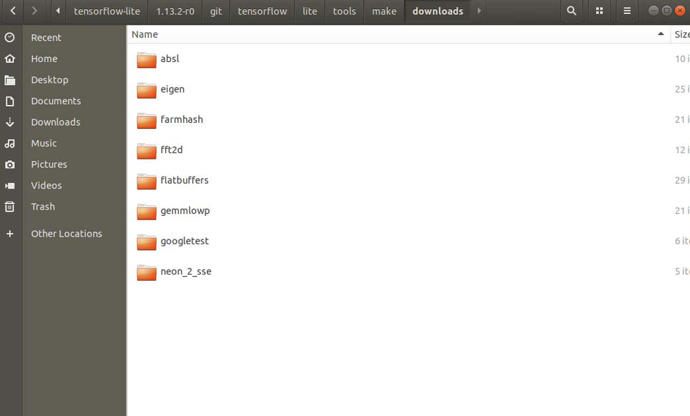

  At the same time, we can open this directory and check if the following directories are created. If these 8 directories are successfully created, it means that links we modified are no problem.
         After tensorflow-lite is successfully built, we can continue to compile full images.
# bitbake imx-image-full
