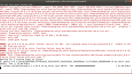

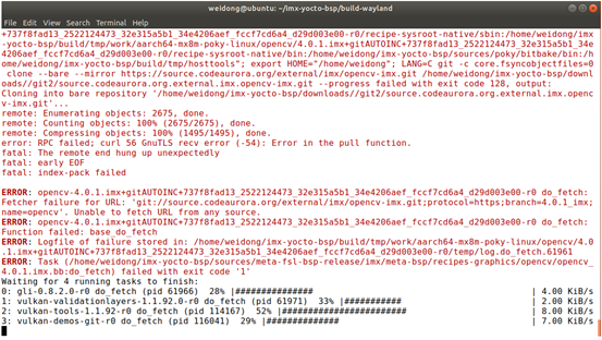

In the process of compilation, there have been many "fetch errors", which are caused by disconnection or timeout of network connection.
We just need to run the bitmake command again in the build Wayland subdirectory to continue the compilation.
# bitbake fsl-image-qt5-validation-imx
         Fetching errors below were what I encountered:

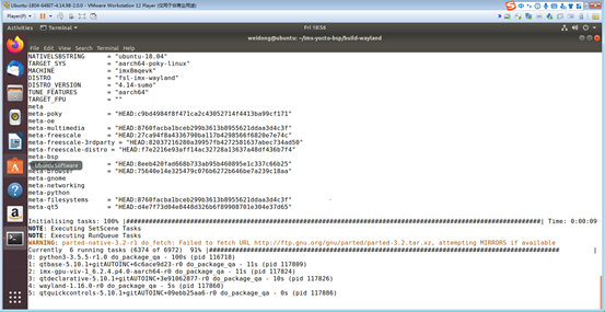

         The following picture is to re-run “bitbake fsl-image-qt5-validation-imx” after fetch errors occurred.
