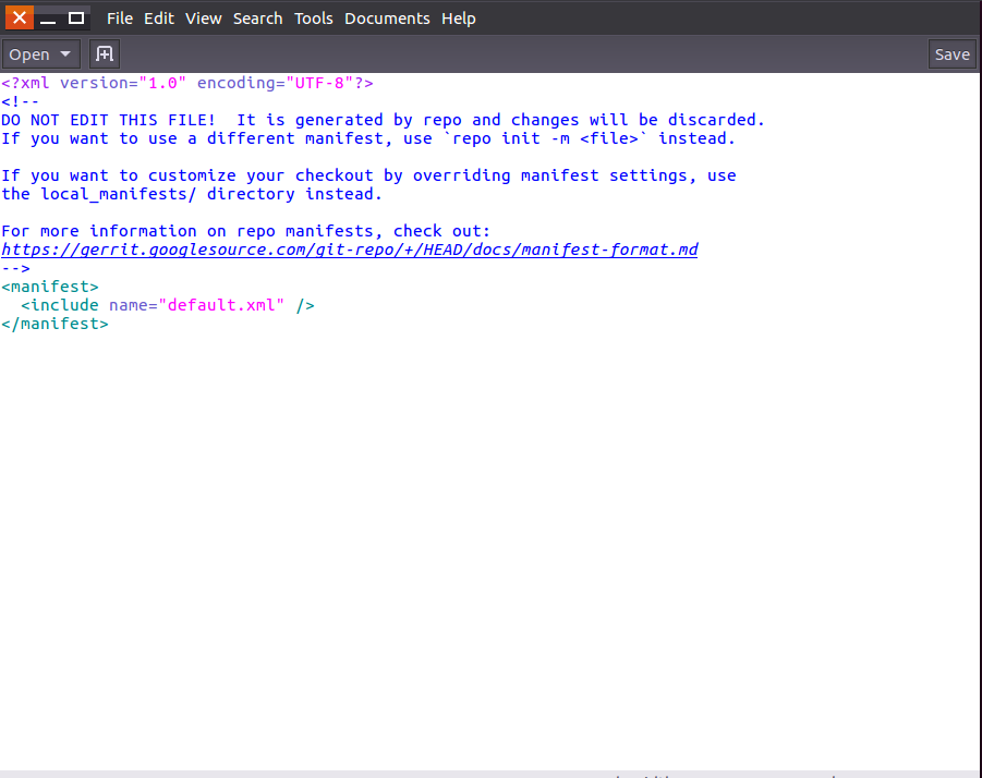

(4) Modifying manifest.xml
# ~/bin/repo init -u https://aosp.tuna.tsinghua.edu.cn/android/platform/manifest -b android-7.1.1_r13
# cd ~/myandroid/.repo
# gedit manifest.xml
Then change the value of fetch to " https://aosp.tuna.tsinghua.edu.cn/android/ ", like
following:

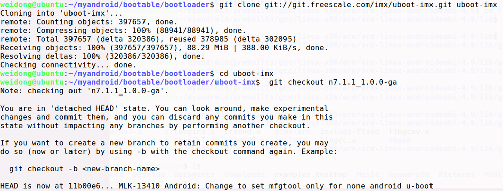

3.2 Getting uboot source code
$ cd ~/myandroid/bootable
$ mkdir bootloader
$ cd bootloader
$ git clone git://git.freescale.com/imx/uboot-imx.git uboot-imx
$ cd uboot-imx
$ git checkout n7.1.1_1.0.0-ga

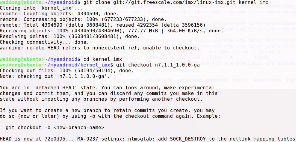

3.3 Downloading linux kernel
$ cd ~/myandroid
$ git clone git://git.freescale.com/imx/linux-imx.git kernel_imx
$ cd kernel_imx

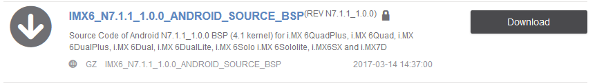

4. Downloading android7.1.1 BSP source code and patch it above source code
4.1 Android7.1.1 BSP can be downloaded from the link:
Android OS for i.MX Applications Processors|NXP
---Board Support Packages (66)
After downloading it, copy it to /opt/

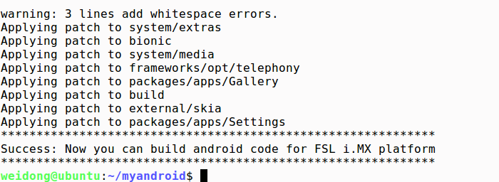

4.2 Patch it to android source code
$ cd ~/myandroid
$ source /opt/android_N7.1.1_1.0.0_source/code/N7.1.1_1.0.0/and_patch.sh
$ help
$ c_patch /opt/android_N7.1.1_1.0.0_source/code/N7.1.1_1.0.0/ imx_N7.1.1_1.0.0
If everything is OK, "c_patch" generates the following output to indicate the successful patch:

Only uboot-imx has n7.1.1_1.0.0-ga tag, but can't find this tag in kernel_imx.
Have tried "git fetch --tags" but nothing happen.
Please help to confirm.
Rick
Update:
I used old git path, and the latest tag is m6.0.1_2.1.0-ga; can find n7 tag after clone with new git link.

weidong.sun‌ Hi Wigros,
Forgive me that i am a new guy. Followed your document step by step and wanted to compile android7.1.1 BSP, i met some questions, in the step of 3.1.2(4)Modifying manifest.xml, i found the contents is not like you said in the document and i don't know how to change them, could you help double check below picture of manifest.xml and guide me how to change it?BTW, in the step of 3.1.2(2)Modifying repo File, i can not fetch " https://gerrit-google.tuna.tsinghua.edu.cn/git-repo", so i have changed the address to " https://mirrors.tuna.tsinghua.edu.cn/git/git-repo/". please help, thanks!
