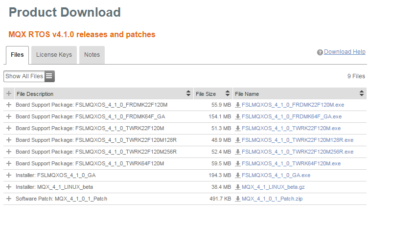

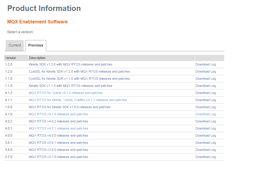

I have downloaded Freescale MQX 4.2 from https://freescale.flexnetoperations.com/control/frse/download?agree=Accept&element=6321767 and supported devices listed in config and build folders are:
frdmk22f120m
frdmk64f
kwikstikk40x256
svf522revb_a5
svf522revb_m4
twrk20d50m
twrk20d72m
twrk21d50m
twrk21f120m
twrk22f120m
twrk24f120m
twrk40d100m
twrk40x256
twrk53n512
twrk60d100m
twrk60f120m
twrk60n512
twrk64f120m
twrk65f180m
twrk70f120m
twrvf65gs10_a5
twrvf65gs10_m4
Am I looking in the wrong place or downloaded wrong version?
Dear Mandic,
On the MQX download list page, please download the version named:
MQX RTOS for i.MX 6SoloX v4.1.0 releases and patches

Hi Sergio,
I'm trying to download the MQX RTOS for i.MX 6SoloX v4.1.0 as suggested but is not available.
I also try the link suggested by Bruno and the following message appear:
Error Message
Either the item was not found, or you are not authorized to download this item.
For Customer Support assistance, please enter a description of the problem and press the "send" button.
Any suggestion?
Any solution?
It doesn't work. This link redirects to my account .
1) Log in with your community.freescale.com account
2) Go to the url
I've done this, but it doesn't work. It must be something related to permission.
