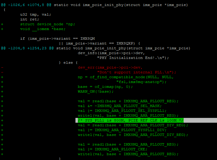

In order to cost down, some customers used CLK2 as PCIe reference clock as below while no external OSC installed, which is different with i.MX8MQ EVK design, so no clock output for PCIe.

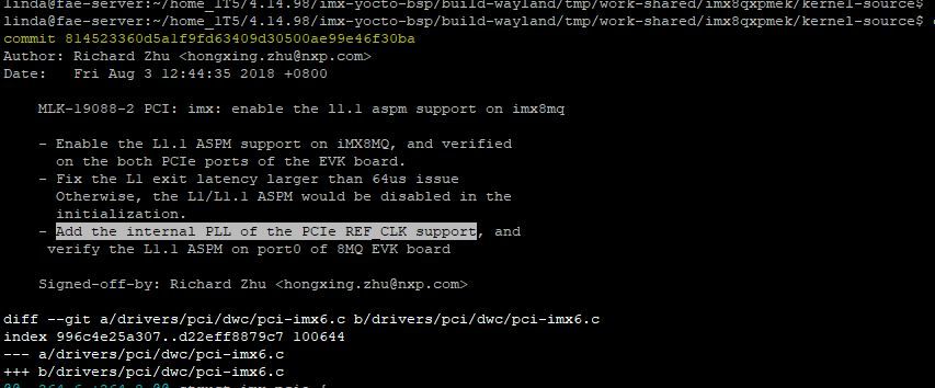

Checked L4.14.98_2.3.0 and found it added internal PLL for PCIe clock support.

The attached patch based on 4.14.98 cant be used directly on 5.10.52, the following is the main modification for PLLOUT of PCIe clock. PLLOUT Monitor Configuration Register contains bits to control the clock that will be generated on the CCM clock mapped to CLK2_P/N.
