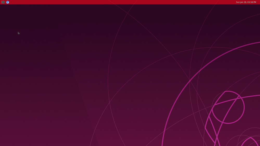

Feature:
  • weston + ubuntu18.04 + 4.14.98 kernel
  • VPU (enable with gplay or gst-play)
  • GPU (could render desktop and run GPU demo under root privileges on Weston Desktop)
I also try ubuntu with gnome desktop, ubuntu18.04 can not run gnome, need use ubuntu19.04. But Gnome Desktop just render by CPU.

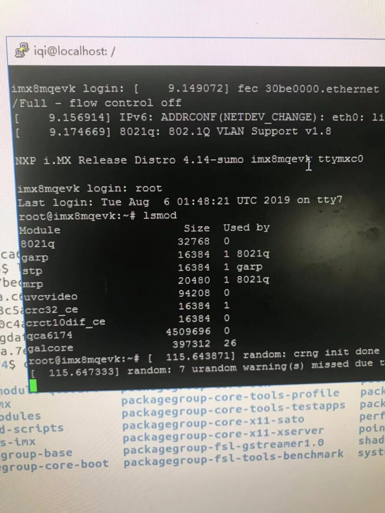

Because the GPU dirver be builded as galcore.ko by yocto default. So compile the kernel separately to make Image include gpu dirver. In kernel source code(I download form linux-imx - i.MX Linux kernel , not use the yocto code), after command $ make menuconfig, you can see the .config
CONFIG_MXC_GPU_VIV=y.

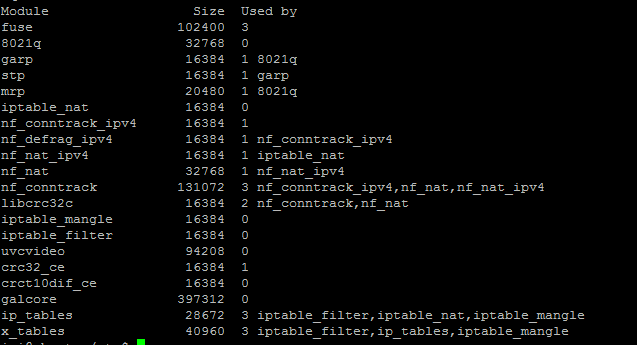

Hi Gnar,
i was curious whether you have tested a webcam with ubuntu and seen if it works?  i'm struggling to get a simple logitech webcam to work.  It looks like i'm getting a dmesg alert that "VPU_firmware_download Failed"... so i assume the VPU firmware is messed up.
maybe i copied in the wrong file at some point...
k
Hi, Kyle
     I am not test webcam but other one test it ok. I am not sure he do other config for it. If you webcam is usb camera, may should enable UVC driver in kernel. About VPU firmware, are you copy it under  /lib/firmware ? You also can copy unit_test file form yocto,  use v4l2 to open camera.
Gnar

Hi, gao
Because in default, GPU driver  galcore is compiled as .ko file, so need compile the kernel separately to make galcore in kernel.
Gnar
thanks for your answer.Can you tell me how to compile the kernel separetely? I use fellowing methods make it :
bitbake -c compile -f -v linux-imx
bitbake linux-imx -c compile_kernelmodules -f -v
bitbake -c deploy -f -v linux-imx
result:
Compare with before:
galcore used numbers different.and no have qca6174 driver.and a lot of drivers have been added。
how to resolve it?
A easy way is download linux-imx for linux-imx - i.MX Linux kernel , Then use command "$ make defconfig,  $ make" to build Image .
Use the Image replace your current Image.
Gnar

Hi Gnar,
We are able to get GUI with Weston, but this GUI look is not like desktop Ubuntu GUI.
Whether you are getting same GUI?
The terminal showing following output,
# lsb_release -a
No LSB modules are available.
Distributor ID: Ubuntu
Description:    Ubuntu 18.04.2 LTS
Release:        18.04
Codename:    bionic
Prashanth Kumar K
Hi,prashanth
You install weston, so it show weston GUI. I think you want to get Gnome GUI, but I enable it just with CPU sotfware render (just apt-get                install gnome-core).   Gnome GUI with GPU render meet some mistakes.
Gnar

Hi, I had update the DOC for enable weston.  See if there is  gpu driver .
root@ubuntu:~# ls /dev/galcore
/dev/galcor
