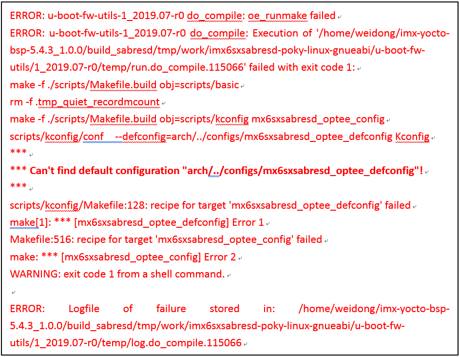

# bitbake u-boot-fw-utils -c compile
         If changing .config to be mx6sxsabresd_optee_defconfig in the top directory of u-boot source code, new errors will occur, like descriptions in the link:
         https://community.nxp.com/message/1318081?commentID=1318081#comment-1318081
         The root cause is that the u-boot is not u-boot-imx.

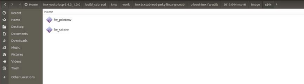

# DISTRO=fsl-imx-fb MACHINE=imx6sxsabresd source imx-setup-release.sh -b build_sabresd
# bitbake u-boot-imx-fw-utils -c compile
# bitbake u-boot-imx-fw-utils -c install
Then you will get fw_printenv & fw_setenv

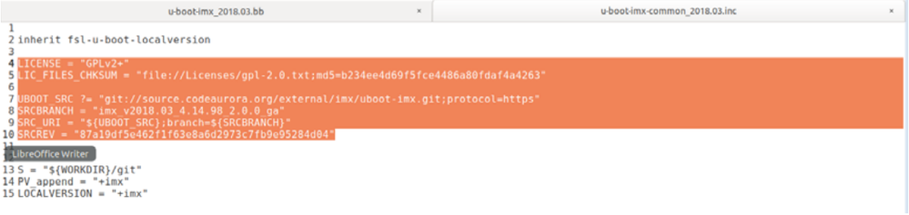

3.Modifying u-boot-imx-common_2018.03.inc
In the directory, there is u-boot-imx_2018.03.bb file, open it, and find the link of u-boot and check sum, and use lines below to replace those lines in u-boot-imx-common_2018.03.inc
In u-boot-imx_2018.03.bb file:
LICENSE = "GPLv2+"
LIC_FILES_CHKSUM = "file://Licenses/gpl-2.0.txt;md5=b234ee4d69f5fce4486a80fdaf4a4263"
UBOOT_SRC ?= "git://source.codeaurora.org/external/imx/uboot-imx.git;protocol=https"
SRCBRANCH = "imx_v2018.03_4.14.98_2.0.0_ga"
SRC_URI = "${UBOOT_SRC};branch=${SRCBRANCH}"
SRCREV = "87a19df5e462f1f63e8a6d2973c7fb9e95284d04"
Then in u-boot-imx-common_2018.03.inc, there is the same contents as above:

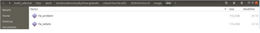

         The same method can be used for other Linux BSP versions.
