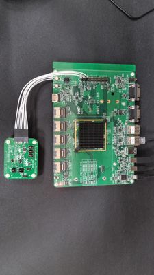

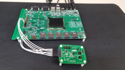

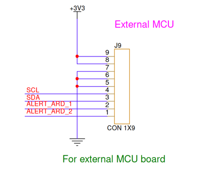

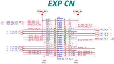

Connections:
We will use the expansion connector of the iMX8MP-EVK and J9 of the P3T1755DP-ARD board.
iMX8MP-EVK
P3T1755DP-ARD ----> iMX8MP-EVK
J9              ---------->            J21
+3v3 (Pin 9) ---> +3v3 (Pin 1)
GND(Pin 7) ---> GND (PIN 9)
SCL (Pin 4) ---> SCL (Pin 5)
SDA (Pin 3) ---> SDA (Pin 3)

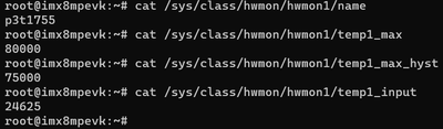

Reading the Sensor
We can read the sensor using the next commands:
Read Temperature:
$ cat /sys/class/hwmon/hwmon1/temp1_input
Reading maximum temperature:
$ cat /sys/class/hwmon/hwmon1/temp1_max
Reading hysteresis:
$ cat /sys/class/hwmon/hwmon1/temp1_max_hyst
