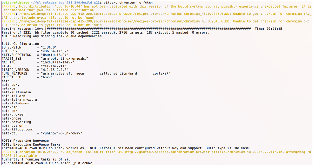

# bitbake chromium -c fetch
      Begin to download chromium package
         If you feel it’s the speed of download is too slow, you can copy the following link to explorer, and download the file directly:
http://gsdview.appspot.com/chromium-browser-official/chromium-48.0.2548.0.tar.xz
Then copy the file to ~/fsl-release-bsp/downloads. And create a.done file by touch command in the directory.
# cd ~/fsl-release-bsp/downloads
# touch chromium-48.0.2548.0.tar.xz.done
         Empty file is OK, not need any contents in the file.

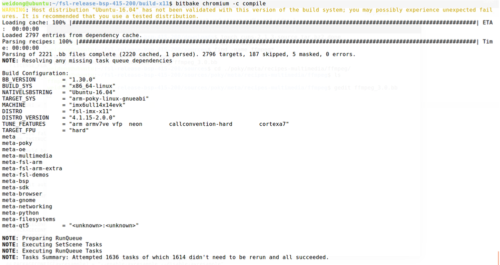

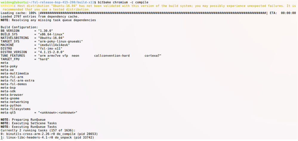

         Begin to compile chromium:
# cd ~/fsl-release-bsp/downloads/build-x11

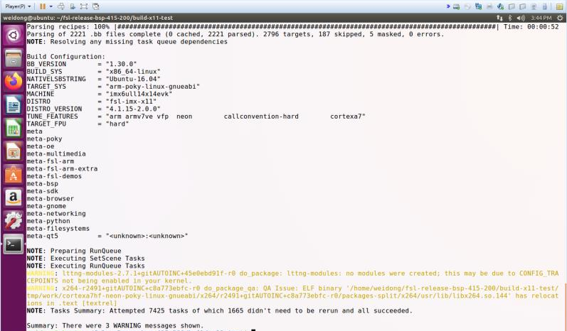

# bitbake chromium -c compile
         From the following picture, total tasks are 1636

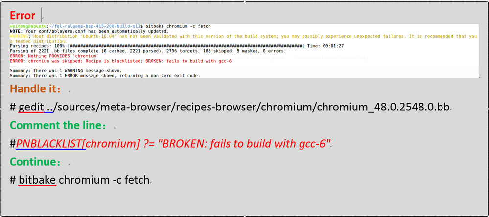

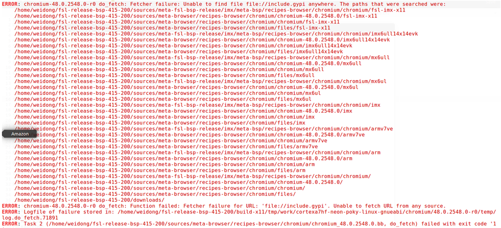

Errors 1 during compilation
Error :

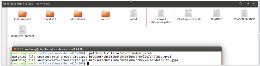

Errors 2 during compilation
Handle it :
  1. copy the fsimx6ul-chromium.patch to your main yocto directory (same directory were you can find yocto-download).
  2. Switch to this directory and apply the patch with the following command: patch -p1 < fsimx6ul-chromium.patch
  3. Compile your yocto rootfs again
[Comment]
The solution is from the link:
https://forum.fs-net.de/index.php?thread/4352-yocto-build-chromium-browser/
fsimx6ul-chromium.patchis provided by F&S Support Team
Continue:
Successfully.
Step 3 Compiling full image
# bitbake fsl-image-gui
         When chromium compilation is done, we can begin to comipile rootfs(fsl-image-gui)
         Then no errors occurred. Compiled BSP successfully.

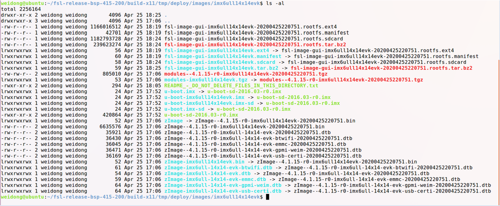

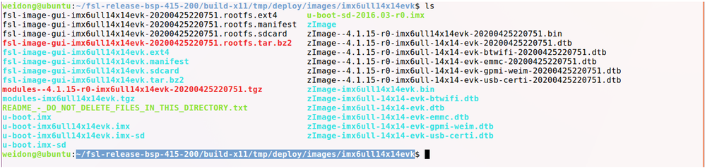

Then we check if chromium has been included in rootfs.
# cd ~/fsl-release-bsp/build-x11/tmp/deploy/images/imx6ull14x14evk
[Comment]
(1) fsl-image-gui-imx6ull14x14evk-20200425220751.rootfs.tar.bz2
         The file is rootfs without u-boot/device tree/linux kernel.
(2) fsl-image-gui-imx6ull14x14evk-20200425220751.rootfs.sdcard
         The file is full image including u-boot/device tree/kernel/rootfs
Here is the links among files:
