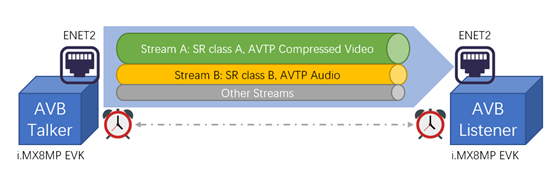

Demo introduction
Two i.MX8MP EVK boards are used for this demo, one act as a AVB talker to send A/V streams, the other one act as a AVB listener to receive A/V streams who can be playback to audio codec and sink video to screen. The two boards are connected by a RJ45 ethernet cable on each ENET2 port (only ENET2 port has TSN features).
Three streams’ type and SR (Stream Reservation) class are defined as below to grantee time sensitive (sub-microsecond synchronization), low latency and bandwidth on the ethernet:
  • Stream A: SR class A, AVTP Compressed Video Format, H.264 profile High, 1920x1080, 30 fps.
  • Stream B: SR class B, AVTP Audio Format, PCM 16-bit sample, 48 kHz, stereo, 12 frames per AVTPDU.
  • Other stream: Best-effort streams
These three TSN streams would be allocated into different traffic control (TC) class for egress in Linux. Different TC class would be mapped to different hardware queues with dedicated DMA channel, thanks to the multi-queue support by ENET_QoS IP. Then the traffic control apply different scheduling policy on each queues for different types of streams egress, to make sure highest priority or critical packet can be sent in the correct time slot.
The TSN streams are transmitted over Virtual LANs (VLANs). Bridges use the VLAN priority information (PCP) to identify Stream Reservation (SR) traffic classes which are handled according to the Forward and Queuing Enhancements for Time-Sensitive Streams (FQTSS) mechanisms described in Chapter 34 of the IEEE 802.1Q standard.

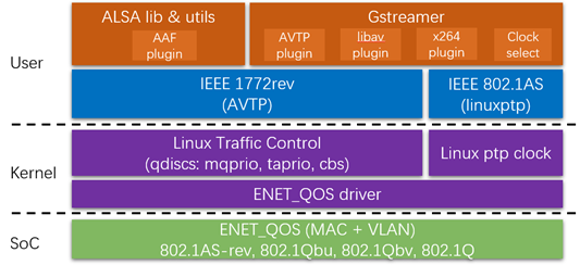

The demo is built up by following blocks:
  • Linux TC (traffic control): streams egress control to meet AVB/TSN requirements, which take advantage of the i.MX8MP TSN ENET IP.
  • Linux PTP: clock sync in network, which take advantage of the i.MX8MP TSN ENET IP.
  • Libavtp: Time Sensitive Applications AV Transport protocol.
  • ALSA: AVTP audio format plugin uses the libavtp to transmit and receive AVTP audio PCM streams.
  • Gstreamer: avtp plugin uses the libavtp to transmit and receive AVTP audio/video streams (video should be encoded as H264, audio PCM). x264enc and libav is a software H.264 video encoder/decoder, which alternative to the on chip VPU acceleration plugin, due to the VPU plugin is not supported in the latest Gstreamer version (1.17.x).

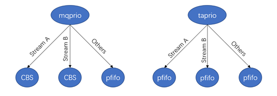

Traffic control
This demo can use two different traffic control qdisc settings:
  • mqprio + cbs: use CBS features
  • taprio + pfifo: use EST and FPE features (802.1Qbu/bv).
The pfifo is the default traffic control class, which use FIFO schedule policy for egress packets. The CBS class is actually handled by hardware IP to select which queue for transmit in a certain time slot.

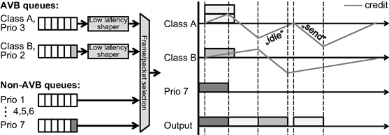

Credit Base Shaper (CBS)
CBS parameters come straight from the IEEE 802.1Q-2018 specification. They are the following:
  • idleSlope: rate credits are accumulated when queue isn’t transmitting;
  • sendSlope: rate credits are spent when queue is transmitting;
  • hiCredit: maximum amount of credits the queue is allowed to have;
  • loCredit: minimum amount of credits the queue is allowed to have;

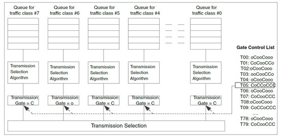

Enhancements to Scheduled Traffic (EST)
The IEEE 802.1Qbv defines the schedule for each of the queues on every egress port which makes the implementation aware of traffic arrival schedule. This information can be used to block the lower priority traffic from transmission in this time window/slot. This ensures that scheduled traffic is forwarded from sender to receiver through all the network nodes with a deterministic delay. The i.MX8MP uses the gate control list with configurable time slot and frame preempt (IEEE 802.1Qbu) features to support EST.
Other than the CBS, the gate control list control the egress transmission by a fixed open interval for that queue.

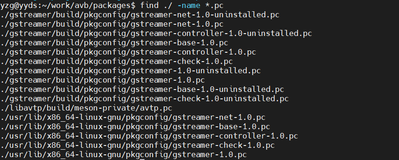

To make sure you have avtp package installed correctly:
$pkg-config --list-all | grep avtp
Copy the .so into the install folder:
$cp build/libavtp.so* <install folder>/usr/lib/

After Gstreamer is installed into <your install folder>, please fix the “prefix” path in the .pc files by, and copy to the toolchain folders:
$cd <your install folder>
$grep -lR <your install folder> ./lib/pkgconfig/ | xargs sed -i 's/<your install folder>/\/usr/g'
NOTE: Make sure you use the ‘\’ for ‘/’ convert in your path.
$cp -rf ./usr/* /opt/fsl-imx-xwayland/5.4-zeus/sysroots/aarch64-poky-linux/usr/

$tc qdisc add dev eth1 parent root handle 100 taprio \
        num_tc 3 \
        map 0 0 2 1 0 0 0 0 0 0 0 0 0 0 0 0 \
        queues 1@0 1@1 1@2 \
        base-time 1000000000 \
        sched-entry S 0x6 300000 \
        sched-entry S 0x2 300000 \
        sched-entry S 0x7 200000 \
        flags 0x2
CBS qdisc
Q1 CBS for video, Q2 CBS for audio:
$tc qdisc replace dev eth1 parent 100:2 handle 777 cbs \
        idleslope 98688 sendslope -901312 hicredit 153 locredit -1389 \
        offload 1
$tc qdisc replace dev eth1 parent 100:3 handle 888 cbs \
        idleslope 3648 sendslope -996352 hicredit 12 locredit -113 \
       offload 1
NOTE: By default, the Q0 will be allocated for pfifo qdisc class if we do not define them.

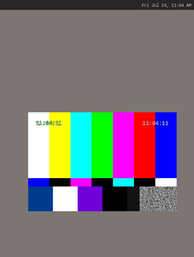

The demo screenshot below: there are two clocks show on the videotestsrc stream: left one is the timestamp recorded before x264enc encoding on the AVB talker side, right one is the timestamp recorded after avdec_h265 decoding and do video convert to YUV frames on AVB listener side. You can see the timestamp is sync in seconds.

@xinyu_chen Where is the path " ./lib/pkgconfig" ?  It doesn't exist under my installer folder.
"./lib/pkgconfig" should mean "lib/pkgconfig" under my installer folder. right?
but there is no "lib/pkgconfig" under my installer folder
@xinyu_chen   I used another command to perform fixing prefix from <my installer flder> to '/usr':
grep -lR '/home/yzg/work/avb/packages' --include='*.pc' .| xargs sed -i 'sI/home/yzg/work/avb/packages|/usr|g'
It worked fine but I am not sure whether this command is correct.
