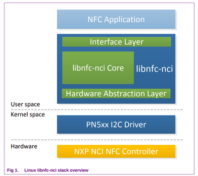

Anybody could let me know if the PN7160 can be used with the libnfc-nci library? I read AN11697, which is a guide for using libnfc-nci with PN7120 and PN7150. However, I couldn't find any information indicating that this library supports the PN7160.
In addition, if the kernel driver nxp-pn5xx also supports PN7160 or not?
By the way, I'm going to integrate a NFC module into a linux board based on I.MX 8MPLUS, and we plan to use PN7160 for the advice from NXP official website
Thanks~~~

Hello @NealZhang
I hope you are doing well.
It appears that the nxp-pn5xx only supports devices of the PN5xx Family. But there is other specific driver for the PN7160.
Also, it appears to be supported by libnfc-nci, as you can see on the AN11697 the libnfc-nci is running at user space with HAL:
But really I cannot to be sure if it is totally compatible.
I hope this can helps to you.
Salas.

NealZhang
Hi, Salas
Thanks very much for your kindly reply.
Actually, I have found the guide of PN7160
https://www.nxp.com.cn/docs/en/application-note/AN13287.pdf
