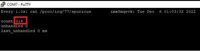

In my understanding,  we can use the following commands to determine whether `gpu` hardware decoder works or not:
user@imx8mqevk:~$ cat /proc/interrupts | grep hantrodec
 77:          0          0          0          0  GPCv2 i.MX8MQ   7 Level     hantrodec
 78:          0          0          0          0  GPCv2 i.MX8MQ   8 Level     hantrodec
Use watch command to observe IRQ77 while playing MP4 videos:
user@imx8mqevk:~$ watch -n1 cat /proc/irq/77/spurious
1) hardnott release (desktop):
2) kirkstone release (desktop):
In my testing,  the same MP4 file and the built-in "Video" player ( totem) have been used.  Why "VPU" hard decoder does not work any more in "kirkstone" release?
thanks a lot for the help!
Best,
Jason

Hi Joan,
I tried to use  "gplay-1.0 xxx.mp4",  but failed.

State changed: buffering
ERROR Error from element /GstPlayBin:playbin/GstURIDecodeBin:uridecodebin0/GstDe codeBin:decodebin0/GstAiurDemux:aiurdemux0: GStreamer encountered a general stre am error.
GStreamer encountered a general stream error.
../git/plugins/aiurdemux/aiurdemux.c(1139): aiurdemux_pull_task (): /GstPlayBin: playbin/GstURIDecodeBin:uridecodebin0/GstDecodeBin:decodebin0/GstAiurDemux:aiurd emux0:
streaming stopped, reason error, state 3 for up.mp4

did you have any issue playback other mp4 files? all of mp4 has this issue or only up.mp4?
2,501 Views
Junjielu
Hi Joan,
I tried several MP4 files and the results were consistent with each other.
Thank you very much!
Best,
Jason
2,463 Views
joanxie
did you use nxp board or your own customized board? I couldn't find any issue on nxp board before when playback the mp4 files, you can download the test files from:
"http://bbb3d.renderfarming.net/download.html"
test the Standard 2D video like 720p, you also can use the command
"gst-launch-1.0 playbin uri=file:///mnt/sdcard/test.mp4"
or
"$ gstreamer-launch-1.0 filesrc location=<video_file> ! \
video/quicktime ! aiurdemux ! h264parse ! vpudec ! \
queue max-size-time=0 ! autovideosink sync=false"
