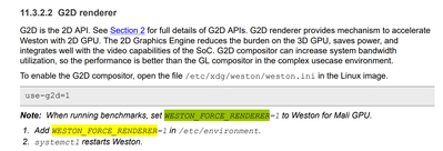

Thanks for your information. Can you try to refer below steps before running benchmark?
Zhiming

Zhiming_Liu
Zhiming

yashwanth_varakala
Hi @Zhiming_Liu
I checked after updating the environment with "WESTON_FORCE_RENDERER=1". Have seen better results
But the step systemctl not updating the environment and seen no change. The environment was updated only after system reboot and seen below better results. @VoVan Can you also please try rebooting system after updating environment.
root@imx95-libra-fpsc-1:~# glmark2-es2-wayland --fullscreen

VoVan
I run glmark2-es2-wayland:
破坏者
root@imx95-19x19-lpddr5-evk:~# export WESTON_FORCE_RENDERER=1                                  root@imx95-19x19-lpddr5-evk:~# cat /etc/xdg/weston/weston.ini                                            [core]
#gbm-format=argb8888
use-g2d=true
repaint-window=16
modules=screen-share.so
idle-time=0
xwayland=true
#enable-overlay-view=1
root@imx95-19x19-lpddr5-evk:~# systemctl restart weston
root@imx95-19x19-lpddr5-evk:~# glmark2-es2-wayland --fullscreen
   glmark2 2023.01
   OpenGL Information

Weston render use g2d - it is ok. But speed of glmark2-es2-wayland in imx8mp higher, wheen speed of glmark2-es2-wayland in imx95.
Differrent between GPU: imx8mp use VivanteGC7000, imx95 use Mali-G310.
VivanteGC7000 use libgbm.so with support gbm_surface_get_in_fence_fd,
Mali-G310 use libgbm.so but no support gbm_surface_get_in_fence_fd....

2,594 次查看
Zhiming_Liu
Hi @VoVan
To update the /etc/environment, please use below commands
vi /etc/environment
copy WESTON_FORCE_RENDERER=1 to /etc/environment
systemctl restart weston.service
Here are results with 1080P
root@imx95evk:~# glmark2-es2-wayland --fullscreen
