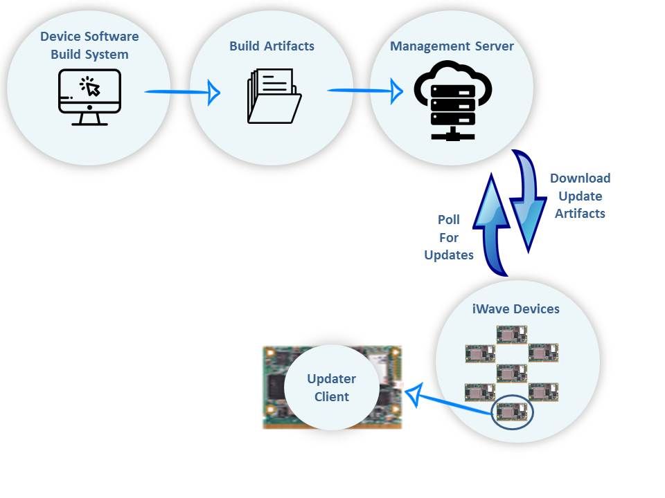

iWave incorporates the OTA update solution using Mender open-source software update manager into our various Linux platforms.
Since Mender is an open-source client-server update manager, we have utilized the full potential of the            service for secure and robust OTA update using iWave’s customization in the following steps:
  1. Develop the software update in device software build system (laptop/PC)
  2. Upload software update artifact to the management server
  3. The Client polls for update from the server and fetches the update if it is available.
  4. The server monitors and manages the updates during this time.
  5. The client device downloads the update artifact and boot into the updated software.
