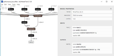

Hi team,
We are using eIQ toolkit for training a object detection model based on VOC dataset. we selected the performance model and trained the model. Once after training the model, we exported the model and by using eIQ model tool, we were able to visualize the model.
The output tensor (Identify) shape of the model is 1x1x25. But as far as we know, the object detection model(https://www.tensorflow.org/lite/examples/object_detection/overview) output tensor will have bounding boxes locations and confidences.
Can anyone please explain the output tensor signature of this model developed in eIQ portal? how to interpret the 1x1x25 tensor output?

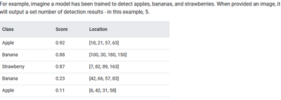

assuming one object per image for performance detection, "[5-7] - Scores" does not make sense as we should get only one score for only one detected class?
Based on https://www.tensorflow.org/lite/examples/object_detection/overview#output_signature and this image
 we should get something like [1,1,6]=[0-3] locations, [4] class, [5] score.

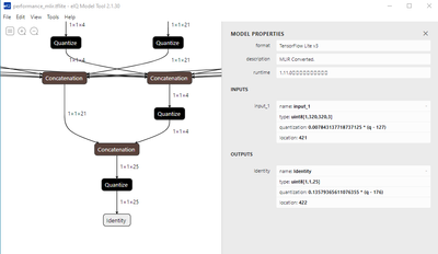

This is output when TOCO is used:
And this is when MLIR is used:
(Note: ignore that [1,1,25], because i have 20 classes, In your case it would be [1,1,8])
If this is the case, try exporting using MLIR optimization and try printing those values, so that we get [1,8] which would be easier to interpret compared to [2034,8].

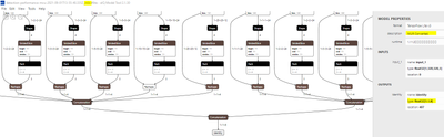

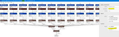

I have used default settings when exporting, and exported name is detection-performance-mcu-2021-09-01T13-55-40.335Z_mlir.tflite (so I believe it refers to MLIR converter option).
[1,1,8] has been read from eIQ Model Tool when I opened exported model, here is how it looks like in my case:
 [2034,8] is from code I attached earlier
I have given a try to TOCO converter and see below:
 Therefore, looks different comparing to your outputs.

@MarcinChelminsk , the int and float difference is because i have used quantization.
From the image u shared, using MLIR converted model, you are getting [1,1,8] output tensor right?. Then in code also it should be [1,8] and not [2034,8]. Try printing those values as you did before. We will try to infer something from that.

 In my case, MLIR model outputs different output tensor shape after calling interpreter.invoke() than before calling this method (please check [1,1,8] vs [1,2034,8)]
OUTPUT DETAILS [{'name': 'Identity', 'index': 407, 'shape': array([1, 1, 8], dtype=int32), 'shape_signature': array([-1, -1,  8], dtype=int32), 'dtype': <class 'numpy.float32'>, 'quantization': (0.0, 0), 'quantization_parameters': {'scales': array([], dtype=float32), 'zero_points': array([], dtype=int32), 'quantized_dimension': 0}, 'sparsity_parameters': {}}]
OUTPUT DETAILS [{'name': 'Identity', 'index': 407, 'shape': array([   1, 2034,    8], dtype=int32), 'shape_signature': array([-1, -1,  8], dtype=int32), 'dtype': <class 'numpy.float32'>, 'quantization': (0.0, 0), 'quantization_parameters': {'scales': array([], dtype=float32), 'zero_points': array([], dtype=int32), 'quantized_dimension': 0}, 'sparsity_parameters': {}}]
 In case of TOCO, they are the same

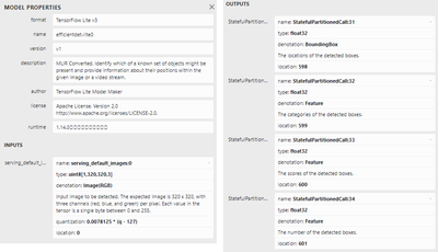

can you run your model through this tutorial: https://www.tensorflow.org/lite/tutorials/model_maker_object_detection ?
As first step before running your own model, I suggest hitting Run in Google Colab and then Runtime->Run All, it creates model.tflite file (it is for detecting 5 classes of food). Checking this reference model in eIQ Model Tool gives as follows:OD_model.tflite_info.PNG
So we can see confirmation of the info you have attached above, output tensor will have locations, classes, scores, number of detections https://www.tensorflow.org/lite/examples/object_detection/overview#output_signature
This info is used in notebook code:
# Get all outputs from the model
  boxes = get_output_tensor(interpreter, 0)
  classes = get_output_tensor(interpreter, 1)
  scores = get_output_tensor(interpreter, 2)
  count = int(get_output_tensor(interpreter, 3))
