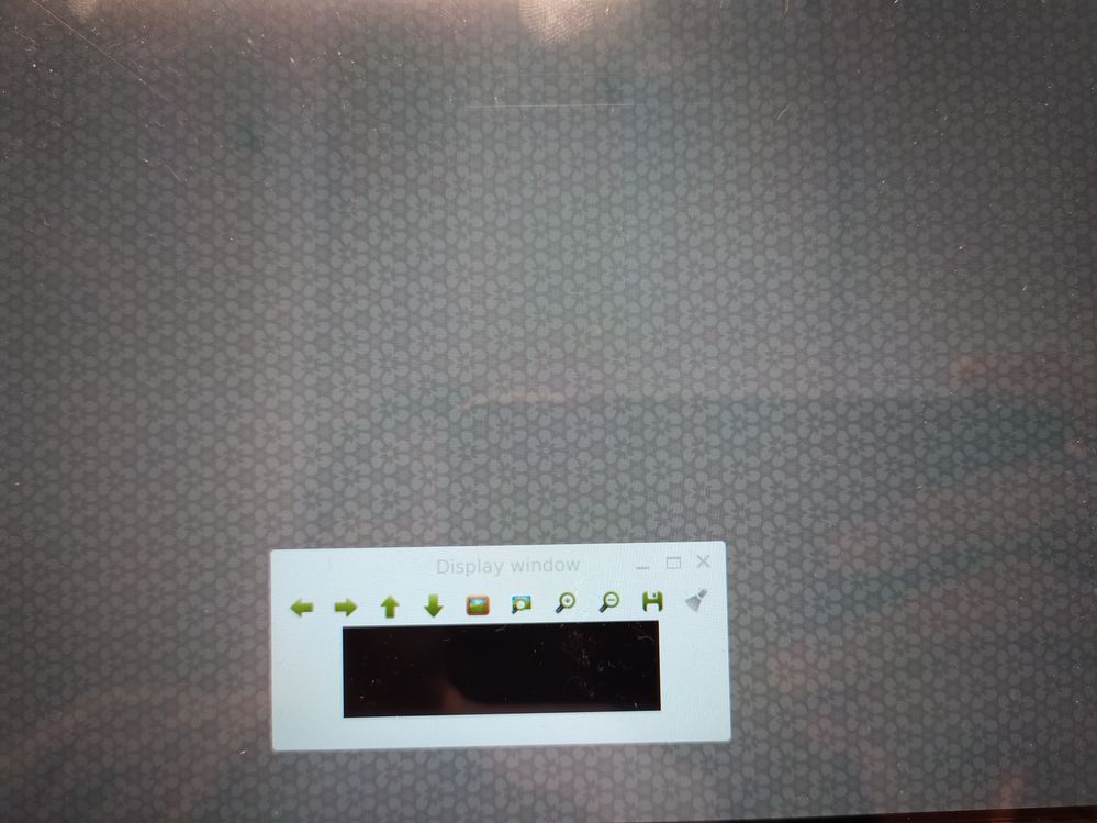

damiano_ciprian
Hi vanessamaegima,
i have run opencv/camera.py and all works correctly. When i run FaceRecognition instead, this is the behaviour:
  • first time after machine boot, application try to start, application window appear for some moment ad then opencv exception is throwed causing application exit. Last output from application is
The all 0faces database is done!
run inference
total time: 67 ms
run inference
total time: 35 ms
  • if now i try again to run it, application stucks as in the image below and i need to reboot machine to replicate exception throwing. Last output from application is
  • if now (i.e. situation when FaceRecognition is not able to continue with execution and stucks) i start opencv/camera.py, this continue to works correctly.
So it seems to be a problem of FaceRecognition only: if you can give me instructions, i make also application debug to try to solve this problem.
Thanks for the support
Damiano
