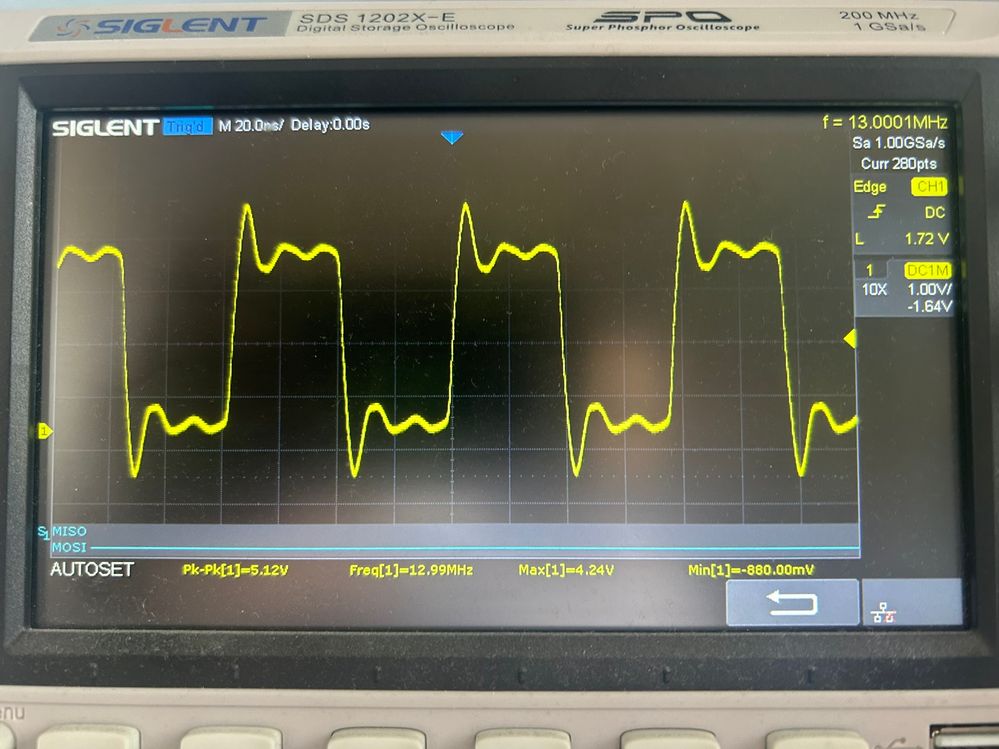

After flashing, I see on console that this example starts correctly. I measured frequency on GPIO56 (exactly on R31 on frdm_rw612 board). Please see image from frdm_rw612 schematic:
Measured frequency is ~13 MHz. According to ksz8081 datasheet it shall not exceed 10MHz and optimal conditions is if this frequency is 2.5 MHz:

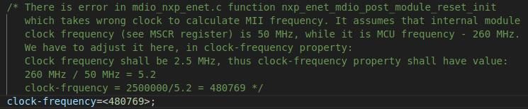

Looking into MSCR register, it seems to have correct value, but in reality it has to be recalculated using 260 MHz frequency, not 50 MHz. Because of that MSCR MII_SPEED is 13MHz instead of 2.5MHz and MSCR HOLDTIME is set to 0 causing connection issues.
I've made some work-around in enet devicetree, but it can't be like that. Using the following method leaves HOLDTIME value wrong and there are still some communication issues.

Here I attach measuring MDC frequency with changed CLOCK_GetTddrMciEnetClkFreq to 260 MHz:
