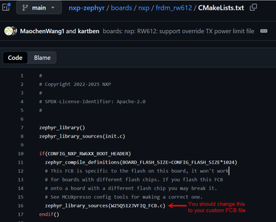

Hello @_arthur_, hope you are doing well.
Could you please confirm if you are adding your custom board to your Zephyr project and if the application you built was meant for the frdm rw612?
For any custom board based on a SoC, it is needed to adapt not only the memory FCB, but also to adapt the device tree, yaml files and CMakeLists. Please refer to the Zephyr Board Porting Guide for more specific recommendations to add your board support to your Zephyr project.
As an additional note, please make sure that you changed the reference to your FCB in the CMakeLists at your board path (for FRDM-RW612, this path is at boards/nxp/frdm_rw612).
Please let me know if the information is useful.
