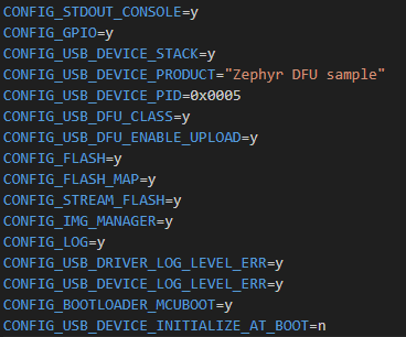

Hi all,
I have an application running on the NXP that communicates with a host application over uart flexcomm0. Working fine. What I want to implement is DFU (using mcumgr from the same host) but I only have this one single flexcomm0 between the host and NXP. So custom commands and DFU need to go over the same flexcomm.
I found a post that says mcumgr can be on a shared uart by just adding CONFIG_MCUMGR_TRANSPORT_SHELL=y to the prj.conf. But seems like it doesn't work. Tried all kinds of combinations but to no avail.
I'm talking about this:
zephyr,console = &flexcomm0;
zephyr,shell-uart = &flexcomm0;
zephyr,uart-mcumgr = &flexcomm0;
My custom parser works fine until the point I enable the CONFIG_MCUMGR=y, so I must be missing some config flags probably.
So question is: can both be on the same port? If yes, what flags should be set (or not set) in the prj.conf?
Thanks in advance!

Hi @ED8500
Apologies the late reply,
The lpcxpresso55s69 has a DFU example, could you please try to add the same configurations to your project?
the example overlay is to enable dfu permanent download

Thanks Carlos for the feedback. The trick was to remove the shell-uart from the app.overlay file and keep the console and uart-mcumgr. In the prj.conf  replace  the CONFIG_MCUMGR_TRANSPORT_UART by CONFIG_MCUMGR_TRANSPORT_SHELL. I'm currently testing it but it seems to work nicely...
