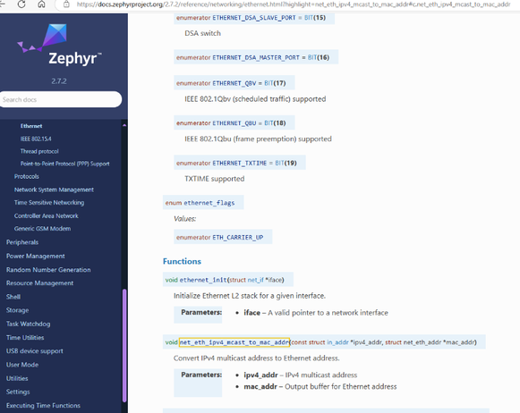

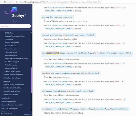

Here you can see that the zsock_sendto function is supported in version 2.7.2
https://docs.zephyrproject.org/2.7.2/reference/networking/ethernet.html?highlight=net_eth_ipv4_mcast...

At moment, the multicast sendto function works fine in my S32R41 platform. While still failed to receive multicast data. I think the main issue is how to add the multicast address into my socket.
1) If use setsockopt() interface, there is no option as "IP_ADD_MEMBERSHIP" ;
2) If use net_ipv4_igmp_join() with CONFIG_NET_IPV4_IGMP enabled, still not work.
So do you have any suggestions for me?
