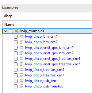

WWarne
Hi Varun-
It sounds like you are using the RT1170 and running into the same issue using the SDK example.  What SDK example did you choose that shows the same error?
Above is a list of the options for RT1170.
Are you using MCUXPresso Eclipse based or VSCode?   What version of SDK are you using?
Thank you
