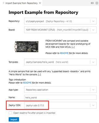

Selecting Zephyr SDK Version
Multiple Zephyr SDK versions can coexist. West uses the latest by default, but you can override it:
  • VS Code: When importing examples, select the Zephyr SDK version in the wizard.
  • CLI: Set the environment variable ZEPHYR_SDK_INSTALL_DIR before building.  This command sets that variable in Ubuntu:
export ZEPHYR_SDK_INSTALL_DIR="/home/<username>/zephyr-sdk-0.17.0"
