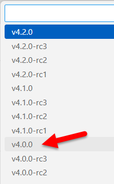

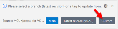

This GUI Guider release requires an older version of Zephyr v4.0.0.  If the Zephyr repo is already imported in VS Code, the MCUXpresso extension can checkout the required version.
Click the MCUXpresso extension, right-click the Zephyr repo to update, and click "Update Repository or Index"
A pop-up appears in the lower right corner.  Click the Custom button to select the release tag
A pull-down appears at the top center.  Select the v4.0.0 release tag.  This will take some time for the extension to checkout this version, and run "west update" to sync all the module repositories.

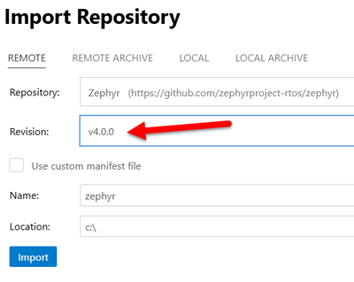

 If the Zephyr repo needs to be imported for the first time, the v4.0.0 version can be selected during the import.  Use the Quickstart Panel in the extension to "Import Repository".  For more help getting started with the MCUXpresso extension and importing Zephyr, see the NXP Zephyr Knowledge Hub.
  • Repository: Zephyr
  • Revision: select v4.0.0

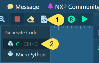

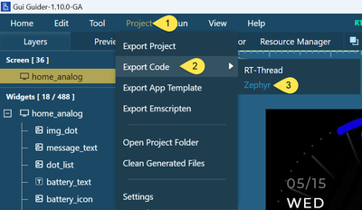

Generate the C code for the project:
Export the code for Zephyr:
Exporting the project into the Zephyr repository is the easiest option to import that project into VS Code.
  • In this example, the Zephyr workspace was setup in C:\z\zephyrproject.
  • The project folder name we will export is gui_guider_demo, and place in the samples folder
  • Then the full path for this exported project is C:\z\zephyrproject\zephyr\samples\gui_guider_demo

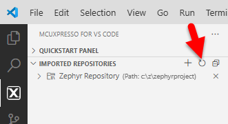

Back in VS Code, in the MCUXpresso extension, refresh the repository to find the newly generated sample project:

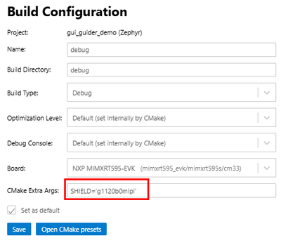

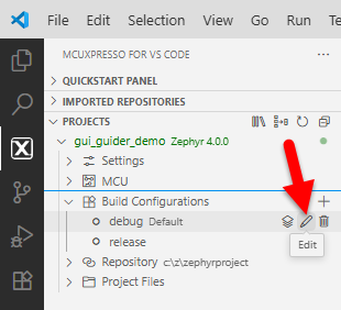

After importing, we also need to add the display shield to the project.  This is done by adding a Cmake variable, see the MCUXpresso Cmake wiki for more details.  In the gui_guider_demo project, click the Edit button for the debug build configuration.
Add the shield name to the CMake Extra arguments using this line, and click the Save button:
SHIELD="g1120b0mipi"

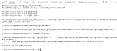

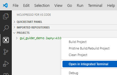

GUI Guider includes git patches in the exported project, and GUIGuider_User_Manual provides steps for apply these patches to the Zephyr and LVGL repositories.  Applying these patches uses CLI, and this article leverages a CLI feature in the MCUXpresso extension.
Right-click the gui_guider_demo project, and select "Open in Integrated Terminal".  This opens the CLI terminal in the project folder, and activates the Python virtual environment.
Enter these CLI commands to apply the patches:
cd ../..
git apply samples\gui_guider_demo\patches\0001-zephyr-Add-build-support-for-new-lvgl-widgets-develo.patch
cd ..\modules\lib\gui\lvgl
git apply ..\..\..\..\zephyr\samples\gui_guider_demo\patches\0001-lvgl-Add-new-widgets-developed-by-NXP.patch

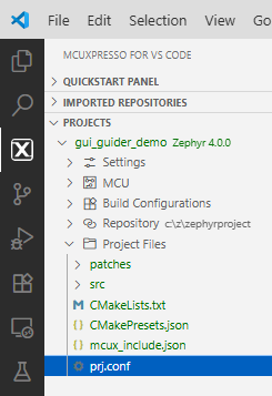

In the exported gui_guider_demo project, open the project file prj.conf.
Update the first two Kconfig settings with these sizes:
CONFIG_LV_Z_MEM_POOL_SIZE=49152
CONFIG_MAIN_STACK_SIZE=4096

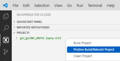

Build and flash the project
The project is now ready to build.  Right-click the project and do a Pristine Build
When the build completes, click the debug icon to program the image to flash.  The app is a very large image and will take some time to program.
