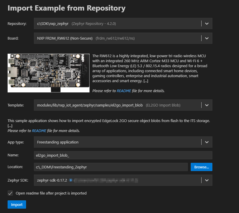

This guide is using el2go_import_blob on frdmrw612//ns as a base example. You may use any TFM based example.  Imported as a freestanding application using VSCode.

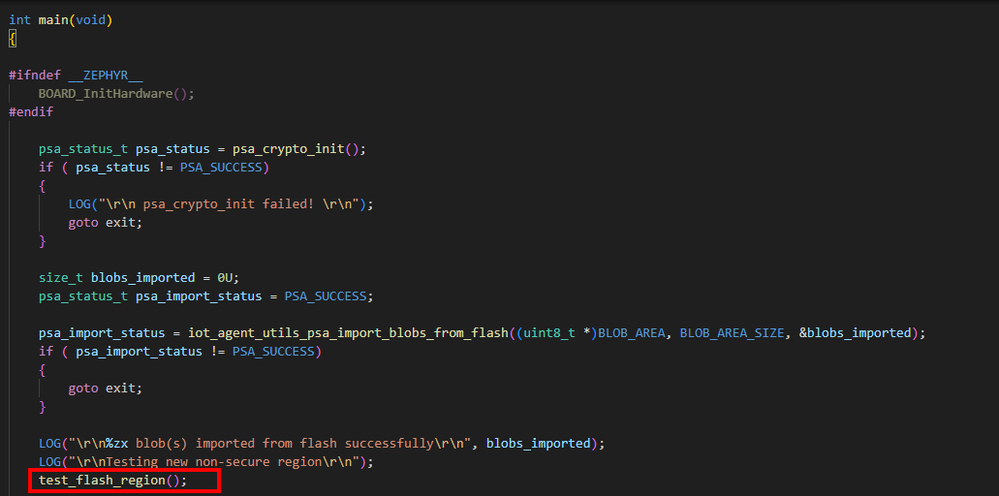

2. Add some test code to the main source file of the project.
#include <zephyr/drivers/flash.h>
const struct device *flash_dev = DEVICE_DT_GET(DT_CHOSEN(zephyr_flash_controller));
static int test_flash_region(void) {
    uint32_t offset = 0x500000;
    uint32_t test_data = 0xDEADBEEF;
    uint32_t read_data;
    // 1. Erase flash (required before write)
    flash_erase(flash_dev, offset, 4096);
    // 2. Write data
    flash_write(flash_dev, offset, &test_data, sizeof(test_data));
    // 3. Read data (this can use memcpy function)
    memcpy(&read_data, (void *)0x08500000, sizeof(read_data));
    if (read_data == test_data) {
        LOG("✓ Flash test passed with memcpy: 0x%08x\n", read_data);
    } else {
        LOG("✗ Flash test failed\n");
//Flash read operation will have fix to correctly calculate address next release
    /*flash_read(flash_dev, offset, &read_data, sizeof(read_data));
        LOG("✓ Flash test passed with flash_read: 0x%08x\n", read_data);
    } else {
    return 0;
3. Call the test_flash_region() function from the main().
