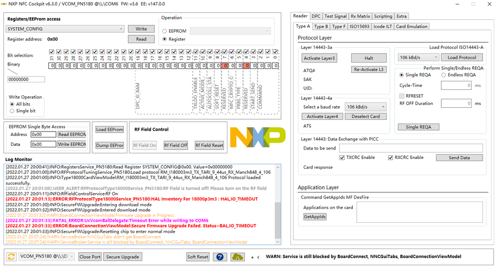

why i cannot upgrade the PN5180's firmware?
[2022.01.27 20:01:33]:FATAL_ERROR:UcVcomBalDelegate:Timeout Error while writing to COM6
[2022.01.27 20:01:33]:ERROR:BoardConnectionViewModel:Secure Firmware Upgrade Failed. Status=BAL,IO_TIMEOUT

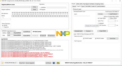

andy_Musk
why i use C:\nxp\NxpNfcCockpit_v6.3.0.0\ABENDToVCOM\fw\lpc_main.bin  file  can read out M1's  UUID,but i cannot operate type B/ISO15693/Felica card successful?  why?

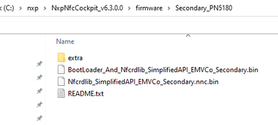

if i want use NXP NFC Cockpit v6.3.0.0 to operate type B/ISO15693/Felica card success,i must burn the C:\nxp\NxpNfcCockpit_v6.3.0.0\firmware\Secondary_PN5180\BootLoader_And_Nfcrdlib_SimplifiedAPI_EMVCo_Secondary.bin file to LPC1769 mcu?
6,761 Views
danielchen
Hi @andy_Musk
I did a quick check, programed BootLoader_And_Nfcrdlib_SimplifiedAPI_EMVCo_Secondary.bin into my PN5180 board with MCUXpresso IDE.   From the cockpit, I can see type B is supported.

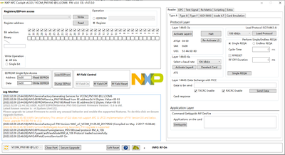

andy_Musk
now i can use my pn5180 demo board to read M1 card with NXP NFC Cockpit v6.3.0.0  tool.but when i upgrade the PN5180's firmware.the  NXP NFC Cockpit v6.3.0.0 tool print error log. i donot know why!!!

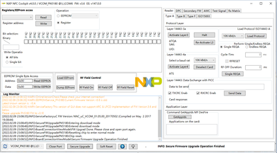

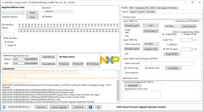

andy_Musk
6,913 Views

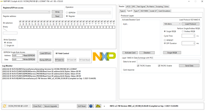

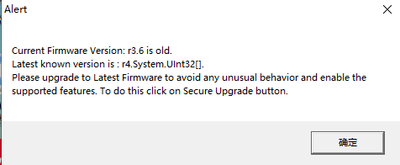

andy_Musk
when i open the NXP NFC Cockpit v6.3.0.0  software. the above interface will show!!!
the bin file run in LPC1769 mcu is C:\nxp\NxpNfcCockpit_v6.3.0.0\ABENDToVCOM\fw\lpc_main.bin
the bin file use in LPC1769 mcu is right?
maybe my PN5180 chip version doesnot support  firmware upgrade?
6,896 Views
danielchen
@andy_Musk
From your picture, your PNEV5180 PC driver is an older version, ABEND driver. This interface has been replaced with a VCOM interface, so the ABEND driver is not required any more. Please install VCOM driver manually.  user manual is AN11744 PN5180 Evaluation board quick start guide.
Please refer to AN11744 , chapter 3 and chapter 5  for more details.
after you install the correct driver, you can update  BootLoader_And_Nfcrdlib_SimplifiedAPI_EMVCo_Secondary.bin file, if you need to use cockpit.
6,855 Views

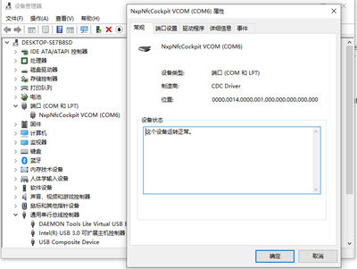

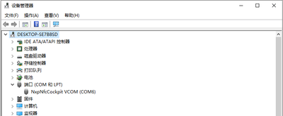

andy_Musk
6,859 Views
andy_Musk
the VCOM driver is installed rightly!!!  you can refer to above picture!
