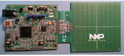

AN11744 is for PNEV5180 board, as below.  but it is different from yours
2,203 次查看
andy_Musk
my PN5180 board just copy from PNEV5180!!! the communicate connection with PN5180  is the same to
NXP.s PNEV5180!!!

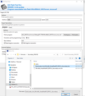

how to use BootLoader_And_Nfcrdlib_SimplifiedAPI_EMVCo_Secondary.bin file ?
how to burn the bin file to LPC1769?

2,161 次查看
danielchen
Please use GUI Flash tool in MCUXpresso IDE. see below picture

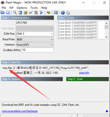

andy_Musk
can i use Flash Magic  to burn the LPC1769  MCU?
but the Flash Magic need use hex format file.  how to convert the bin file to hex file ?
2,140 次查看
andy_Musk
i have not install  MCUXpresso IDE.  and i have not the LPClink  JTAG tool.
what can  i do ?
