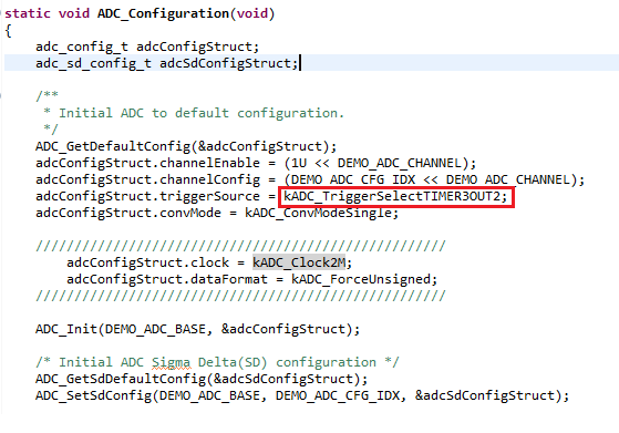

Hi Chris,
I tried to replicate the issue by configuring the ADC as you did, but I actually was able to sample faster than 500 Hz (1 kHz and 2 kHz with no problem).
As you can see the only difference is that I didn't use the software trigger, I used the CTIMER instead to trigger the ADC. The timer configuration is the following:
My best guess is that some other area of your code is causing this issue, I recommend you to try the example I used from the SDK (adc interrupt) adding the timer config and see if you get the same problem.
Felipe.
