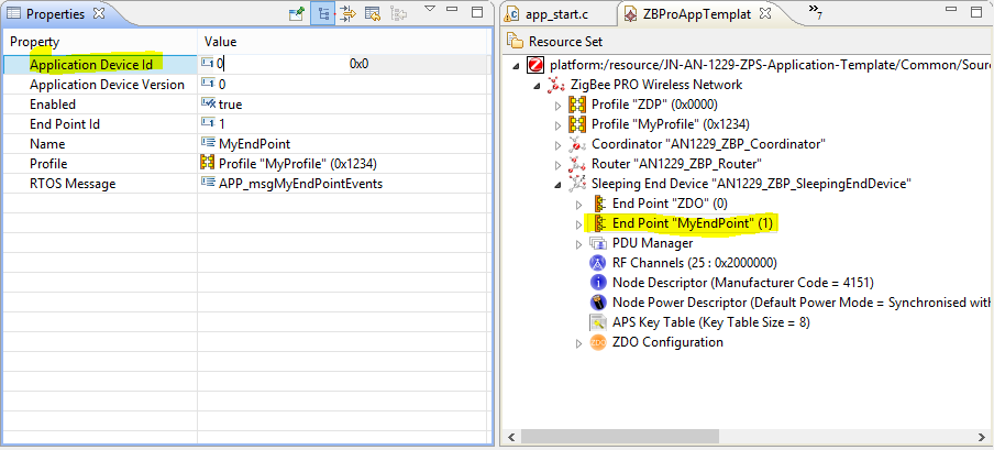

hi,
where to set up device id of simple descriptor within endpoint, I found nothing about device id within eHA_RegisterxxxEndPoint function or other source code. I'm working with zigbee stack JN-SW-4168.

You can set device id in ZPS Configuration Editor in the chosen End Point

jason525
hi David
thanks! this answer is helpful for me.
