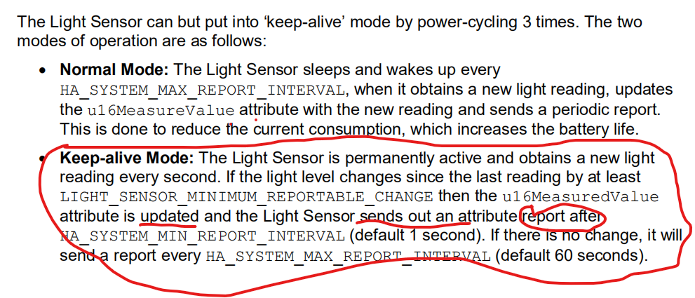

the Light Sensor is not sends out an attribute report after HA_SYSTEM_MIN_REPORT_INTERVAL (default 1 second).

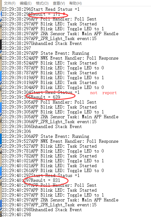

I use the JN-AN-1189 project to compile the Light Sensor option and download it to the development board of your official website. According to the operation of the document, when the brightness of the light changes (greater than 1), why not send the attribute report immediately?
The operation is as follows:
The light level change, why it is not sending a report?

I have bound the coordinator and it can also report regularly (time is HA_SYSTEM_MAX_REPORT_INTERVAL=60s). But what I want to achieve is that when the brightness of the light changes more than 1, I let it report immediately instead of until the reporting cycle. The document says that LIGHT_SENSOR_MINIMUM_REPORTABLE_CHANGE=1, HA_SYSTEM_MIN_REPORT_INTERVAL=1, can be reported immediately when the illumination changes (greater than 1), but I can not achieve it.
Is my configuration wrong?

The macro configurations you specified mean that the device should be reporting the change in brightness every second if the brightness changes more than 1 unit, and if the brightness doesn't change more than 1 unit, then the report will be generated every 60 seconds. Maybe the brightness value is not changing enough, so it's not reporting a change until the max report time passes.
Could you please provide a sniffer log file so I can better examine the problem?

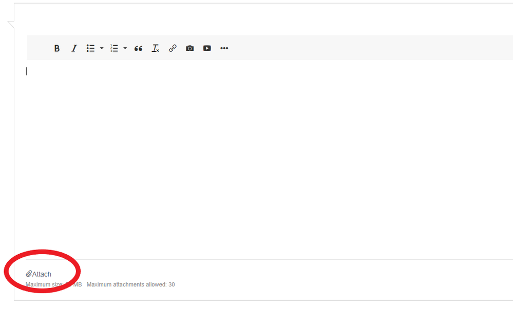

Hi Daniel,
To attach a file, you can click on the "Advanced Editor" button when creating a reply, and on the bottom of the text box you'll see a button that you can click to upload a file.

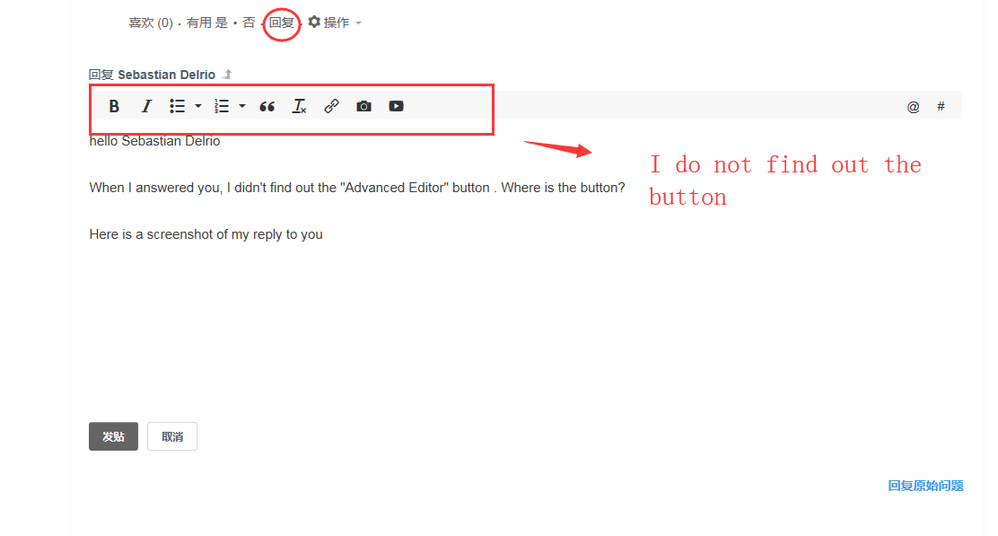

yuboli
hello Sebastian Delrio
When I answered you, I didn't find out the "Advanced Editor" button . Where is the button?
Here is a screenshot of my reply to you
Where is the "Advanced Editor" button .
Thank you

Hi Daniel,
The button for the advanced editor should be located on top of the normal editor box:
If it's not appearing, could you please try using a different web browser?

 When the brightness changes (greater than 1), it does not have an immediate reporting attribute; it is only a periodic reporting attribute
Here's a snapshot log and a screenshot
