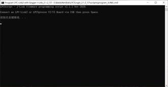

 when I try to use " program lpc-link2 with segger j-link " to update the firmware, it will quit directly,so what should i do to make it show  fig3   BKAH(I[]AP}AE5BWVDD8WUM.pngjlink.pngCX8JZTZ0RFCUQNQ)5CMNOKD.png

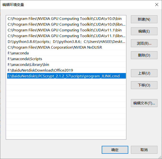

nxf56274
This is the problem of the PATH environment variable. Adding the directory of the windows command to the PATH will overwrite. That is: append to the path: %SystemRoot%\system32;%SystemRoot%;

1758793535
I have tried my best to do ,but it still someting wrongBL5%A(8Q$39RL$6{C3)YN83.png

Do you press  'space' to start update?
TIC
- We are following threads for 7 days after the last post, later replies are ignored
4,931 Views
1758793535
Yes,  i  pressed the "space", it just moved to the next line.
