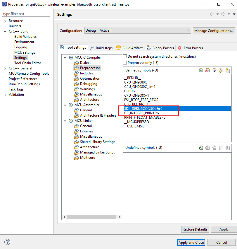

I try to add printf() in qn908xcdk_wireless_examples_bluetooth_otap_client_att_freertos.
I just copy some code from qn908xcdk_rtso_examples_freertos_hello.
But I always get compile error "undefined reference to `_printf'"
Do you know how to add printf() in qn908xcdk_wireless_examples_bluetooth_otap_client_att_freertos ?
I use MCUXpresso IDE v11.0.1, QN9080SIP development kit.

For this linker issue are two options:
1. using SDK_DEBUGCONSOLE. For this we will have to enable this define from project options, like below:
2. using _printf based on the Redlib implementation:
For this let the SDK_DEBUGCONSOLE set to 0 and remove CR_INTEGER_PRINTF
Please also take a look at the SDK_DEBUGCONSOLE_UART define.
(here are also some details for a similar topic: https://community.nxp.com/thread/389140 )
Ovidiu
