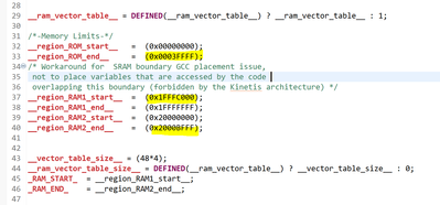

Then I tried to import the ieee802.15.4 wireless example msn_end_device_bm for FRDM_KW41Z512. I had followed the same steps as above. Additionally, I modified memory limits in the linker file as following:
/*-Memory Limits-*/
__region_ROM_start__ = (0x00000000);
__region_ROM_end__ = (0x0003FFFF);
/* Workaround for SRAM boundary GCC placement issue,
not to place variables that are accessed by the code
overlapping this boundary (forbidden by the Kinetis architecture) */
__region_RAM1_start__ = (0x1FFFC000);
__region_RAM1_end__ = (0x1FFFFFFF);
__region_RAM2_start__ = (0x20000000);
__region_RAM2_end__ = (0x2000BFFF);

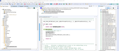

Now, I was able to build the project successfully and download the code into the same board (KW21Z256) using JLink. However, when I tried to debug the project, the program did not start at main(). It went to an unexpected and unknown location, even after I clicked "Restart" Button.
When I clicked "Suspend" Button, the Debug Window shown the following information:
frdmkw41z_wireless_examples_ieee_802_15_4_msn_end_device_bm JLink Debug [GDB SEGGER Interface Debugging]
frdmkw41z_wireless_examples_ieee_802_15_4_msn_end_device_bm.axf
Thread #1 57005 (Suspended : Signal : SIGTRAP:Trace/breakpoint trap)
__udivsi3() at 0x600
__aeabi_fsub() at 0x1610
0x100
arm-none-eabi-gdb (8.3.0.20190703)

-Could you please provide an image that the issue that you are facing and capture the IDE that when the issue occurs?
Is it possible that you could share the complete project that you modify?
-It is a very strange issue, however, is it possible that you could create a new project and copy all the folders that the projects need to run the 802.15.4 example?
Mario

I just created the project from the example and modified the memory size and memory start address in the linker file (MKW41Z512xxx4_connectivity.ld) as following.
Then I changed the MCU type to MKW21Z256xxx4 and memory setting in MCU settings.
 Finally, I tested the project with KW41Z512 MCU using jLink, it worked well. The program started in main() as expected.
However, when I tested the same project with KW21Z256 MCU, it failed. The program did not start in main() as expected. When I pressed "Pause" button, it showed as following.
Are there any settings missed in the project?
Please kindly advise.
Thank you!

For the linker file (MKW41Z512xxx4_connectivity.icf), I changed the memory Limits Section as followings:
/*-Memory Limits-*/
define symbol __region_ROM_start__ = 0x0;
define symbol __region_ROM_end__ = 0x0003FFFF;
define symbol __region_RAM_start__ = 0x1FFFC000;  /*0x1FFF8000*/
define symbol __region_RAM_end__ = 0x2000BFFF;  /*0x20017FFF*/
