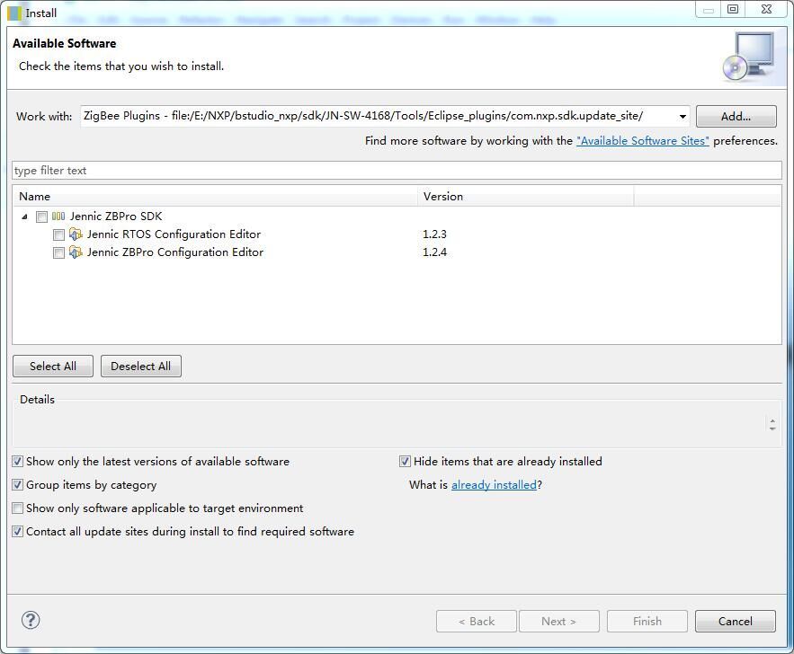

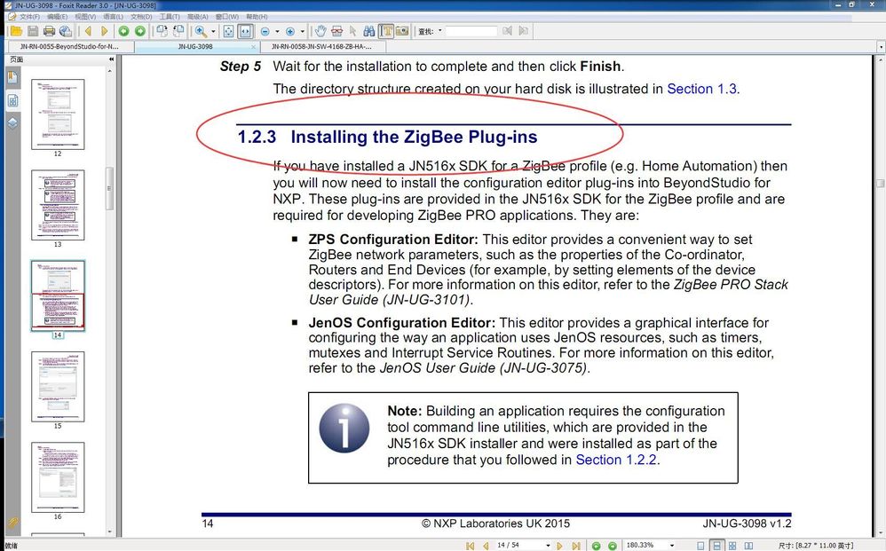

i am reading the chapter 1.2.3 -Installing the ZigBee Plug-ins of the JN-UG-3098 pdf and try to Installing the ZigBee Plug-ins,but i failed and tell me that Cannot complete the install because one or more required items could not be found.
Details are as follows:

The Release Notes mentioned that you must install the toolchain from:
JN-SW-4141 Beyond Studio for NXP v1217.exe
Did you installed this software?
For install the software, you have to following the request form, see the next link
ZigBee 3.0|NXP
Let me know if you already have the software or if you have the same  problem.

zhijie_liang
Thank you! I have already finish to installing it

I had the same problem.
The solving was very simple.
You should install plug-ins from newer existing SDK's  Like JN-SW-4170.
