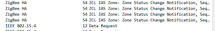

HI,
I am working with   JN-SW-4168 SDK    and  JN5169.   My work is based on JN-AN-1201.
When device attributes change is how the data is sent, how do I know if the data is sent successfully or fails, and if it fails how to control the retransmit? How to control the number of data retransmitted.

 I am working with the ZigBee HA Intruder Alarm System.  I am working with JN-AN-1201.
 I am  developing  an IAS  ZONE  device.
The Zone device  can be successfully coded with a CIE. Automatic Attribute Reporting Approach is Applied.
When the Zone device is away from the gateway(CIE), the report may fail.
As shown above, when the transmission of Zone Status Change Notification  fails, it will be retransmitted four times. I want to retransmit more times. How to set it up?

Hi Liang,
If the transmission was direct, the originator retransmits the data, and this entire sequence may be repeated up to a maximum of macMaxFrameRetries times; if a data transfer attempt fails a total of (1 + macMaxFrameRetries) times, the originator MAC sublayer will issue a failure confirmation to the next higher layer
Please look at the next define
"C:\NXP\bstudio_nxp\sdk\JN-SW-4168\Components\MAC\Include\mac_pib_CombinedMac.h"
/** Default Maximum Frame Retries */
#define MAC_PIB_MAX_FRAME_RETRIES_DEF               ((uint8)3)‍‍
