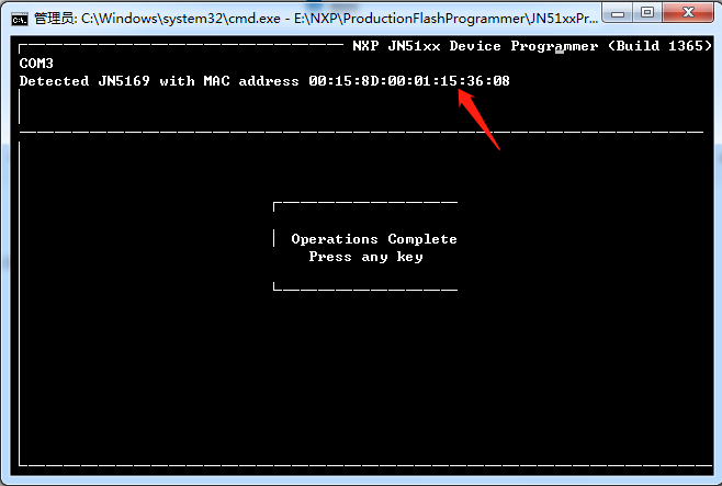

Hi:
  how to  extract MAC address ? (JN5169 )
for example
标记 (1)

Hi Gan Wei
A unique MAC Address is programmed by NXP into the internal Flash and is what is used by default by the stack.
ZPS_u64AplZdoGetIeeeAddr ()
This function obtains the 64-bit IEEE (MAC) address of the local node.
Returns: 64-bit IEEE/MAC address obtained
For a better reference: ZigBee 3.0 Stack User Guide
We also provide a Production Flash programmer tool which can be used to program MAC address one time into the specific flash location.
Support Resources for JN516x MCUs
JN-SW-4107 Utility for loading built applications into JN51xx devices in a production environment. For details, refer to the User Guide JN-UG-3099.

lightwei
HI Mario:
This problem has been resolved
thank you very much
gan wei
