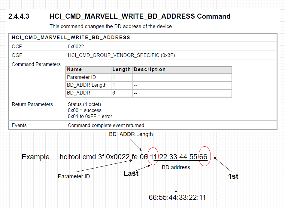

I am working with a module based on the 88W8997 chipset. We have a need to change the device's public BD address. Is there a vendor-specific command for doing so? What specific internal documents do I need to request access to?

Dear @mike16 ,
See below, please!
Thanks!

Dear @mike16 ,
See below, please!
Thanks!
