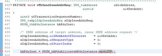

Build error: 'apduZDP' undeclared (first use in this function)
I searched but couldn't find apduZDP.
../zigbee/BDB/Source/FindAndBind/bdb_fb_initiator.c:504:48: error: 'apduZDP' undeclared (first use in this function)
arm-none-eabi-gcc -std=gnu99 -DCPU_K32W1480VFTA -DCPU_K32W1480VFTA_cm33 -
MT"source/app_main.d" -o "source/app_main.o" "../source/app_main.c"
  504 |     hAPduInst = PDUM_hAPduAllocateAPduInstance(apduZDP);

SDK Details
  • Windows
  • 24.12.00
  • K32W148-EVK
  • MCUXpresso IDE
Import SDK example : zigbee_coordinator_freertos

Hope you are doing well.
This error may be due to some missing python modules, could you please try installing lxml module for python? You can try using:
pip install lxml
This action does a modification in the content for .h files, so the library content inside pdum_gen.h changes, this modification declares the apduZDP and apduZCL inside this library.
