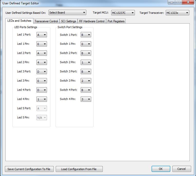

Dear Nidhal,
BeeKit has a way to define custom board’s connections using the “User Defined Target Editor” when creating a new solution.  This enables you to create sample applications from BeeKit and targeted for your custom board with minimal efforts. You could also modify simple ports configuration directly in source code anyway.

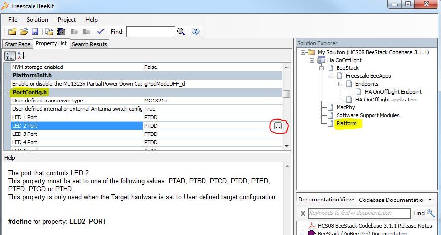

Dear Nidhal,
You may launch the User defined target editor from the Beekit Project’s property list. Once you are done with the New project’s Wizard, click on “Platform” in the solution explorer window (top-right side).
Once there, browse to PortConfig.h section in property list and select any item, i.e. any LED. In the right side of it is located the corresponding port. You may click on the ”…” button to launch the target editor. Following screenshot illustrates this.
