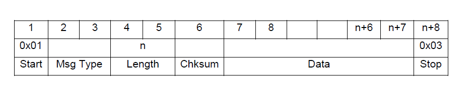

mario_castaneda
HI Sudhamani Bijivemula,
Please look at the Application Note ZigBee 3.0 IoT Control Bridge and look at the Appendix A: Serial Protocol.
"\KW41_SDK\docs\wireless\Zigbee\Application Notes\AN12063-MKW41Z-AN-ZigBee-3-0-ControlBridge.pdf"
You should program the KW41 with the Control bridge example, and through the UART commands could control the Zigbee network. You have to implement it in Linux, please look at the next frame.
Mario
5,057 Views
sudhamani_b
Thanks for the response.
I want to implement serial protocol based test application in Linux.
To go this I want to refer source code of windows based ZGUI test tool application.
Where can I get the source code.
Any other references related to this will be more useful.
Any help would be appreciated.
Sudhamani.
