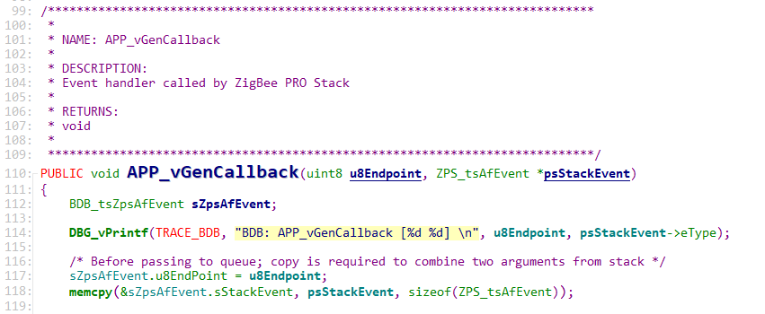

Coordinator changed from Zigbee 1.2(JN-AN-1223) to Zigbee 3.0(JN-AN-1216).
ZigBee 3.0 does not receive leave event of the end device.
Environment When no event occurs (ZPS_EVENT_NWK_LEAVE_INDICATION )
- zigbee 3.0 : JN-AN-1216-Zigbee-3-0-IoT-ControlBridge-v1011
- Coordinator : JN-AN-1216
- End Device : Ember Zigbee
The event does not occur in the following source code.

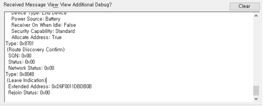

 Environment when event occurs
TEST #1 :
-  Change End Device to Jn5169
TEST #2 :
- zibee 1.2 : JN-AN-1223-ZigBee-IoT-Gateway-v1014
- Change Coordinator to Zigbee 1.2

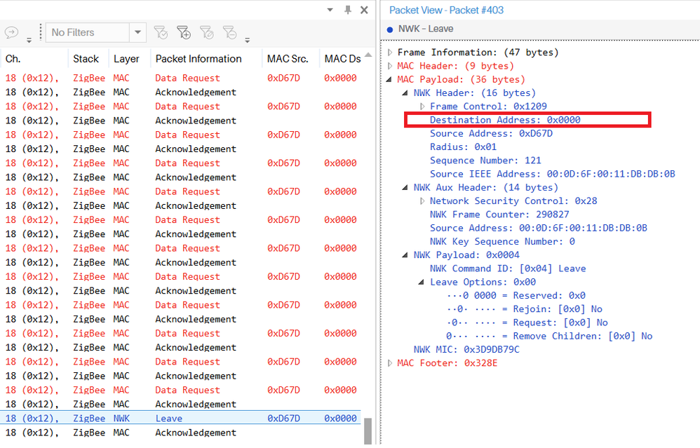

seunghokims
Hi,Sebastian
Thank you for your reply.
Yes, there is no problem with Jn5169.
And with the Zigbee Pro (AN-1223), both Jn5169 and Ember are no problem.
Problems occur in Zigbee 3.0 (An-1216 & An-1217).
When guessing, It doesn't seem to be received when the destination Address is 0x0000.
log is attached.
- An1223 succeeds in receiving.
- The log does not show any difference.
- There is no event received by App_vGenCallback in An-1216.
Kim

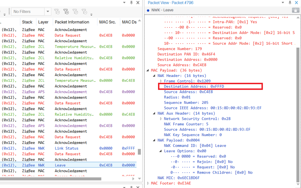

Hi Kim,
I tried replicating your issue, but the event is being generated accordingly.
I noticed a difference in the sniffer logs you provided and the one in my tests:
The Leave packet has a destination address of 0xFFFD, which is one of the broadcast modes, sending the message to all non-sleeping nodes on the network. On the sniffer logs you provided, this address is instead 0x0000.
I attached a sniffer log of the test performed on my side.
Sebastian

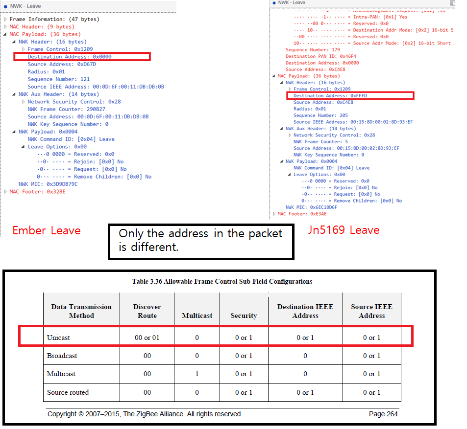

seunghokims
Hi,Sebastian
I know too.
And with the Zigbee Pro (AN-1223), Ember are no problem.
Only, ....  Problems occur in Zigbee 3.0 (An-1216 & An-1217).
The problem is that Zigbee 3.0 does not receive the Ember Zigbee Leave event.
The problem is very serious.
- Our product is a wall pad with HomeAutomation1.2.
 More than 30,000 units have already been sold.
 Ember sensor node is connected to the wall pad.
 We are planning to update Wallpad to Zigbee 3.0.
 However, the leave event is not received when the Ember sensor leaves.
At this time, the only difference between the logs is destination Address 0x0000 and 0xfffd.
Kim

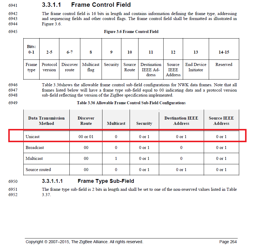

seunghokims
Hi,Sebastian
Unicast is also supported in the ZigBee 3.0 Specification.
I think Adddress(0x0000) should be able to receive.
Is it correct to receive only  0xfffd?
Kim
6,236 Views
Sebastian_Del_Rio
Hi Kim,
Unicast is one of the features supported in ZigBee 3.0, and is implemented in the NXP JN516x ZigBee 3.0 Stack.
The problem could be related to the Ember device not supporting ZigBee 3.0, thus not generating the leave network event properly.
Sebastian

seunghokims
Hi,Sebastian
The NXP JN516x ZigBee 3.0 Stack does not seem to have received the Leave command in the NWK command frame in unicast.
Looking at the sniffer log I provided, Ember device follows the ZigBee specification.  (AN-1216-ControlBridge&Ember.subx.zip)
-  Could there be something other than what is shown in the sniffer log?
Please test with this function in Jn5169.
- ZPS_eAplZdoLeaveNetwork(0,0,0);
- Test it by changing the Destination address from 0xfffd to 0x0000.
Kim
