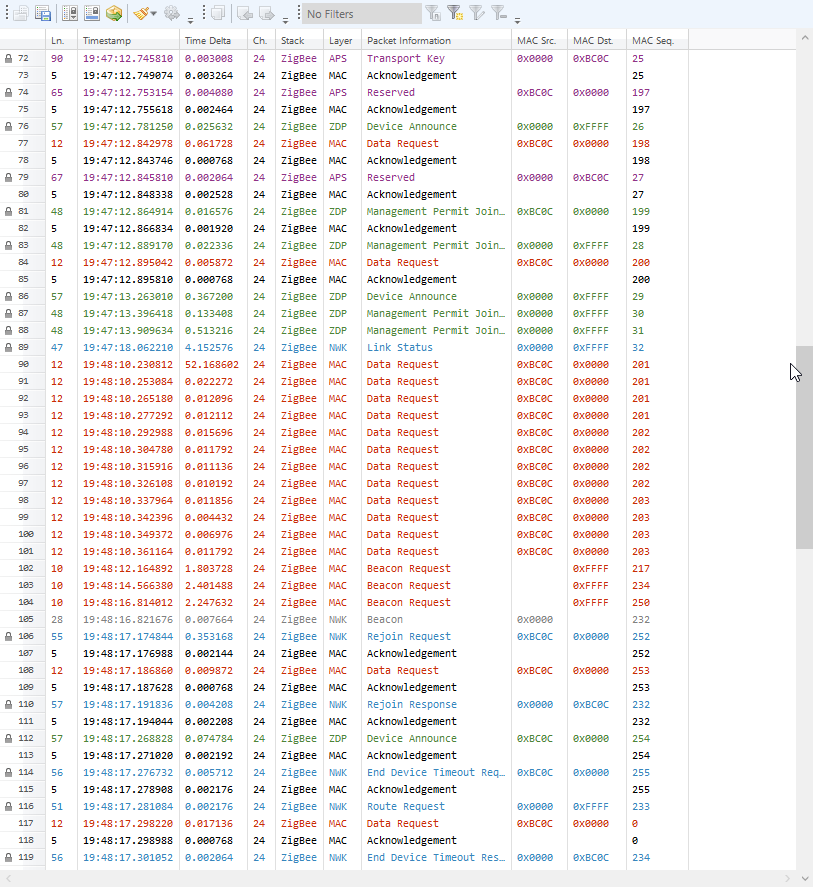

This is my sniffer log, and after I turn off the coordinator, the SED start to sent data request and beacon. Then, I turn on the coordinator and the device send the join request.
Hope it helps.
