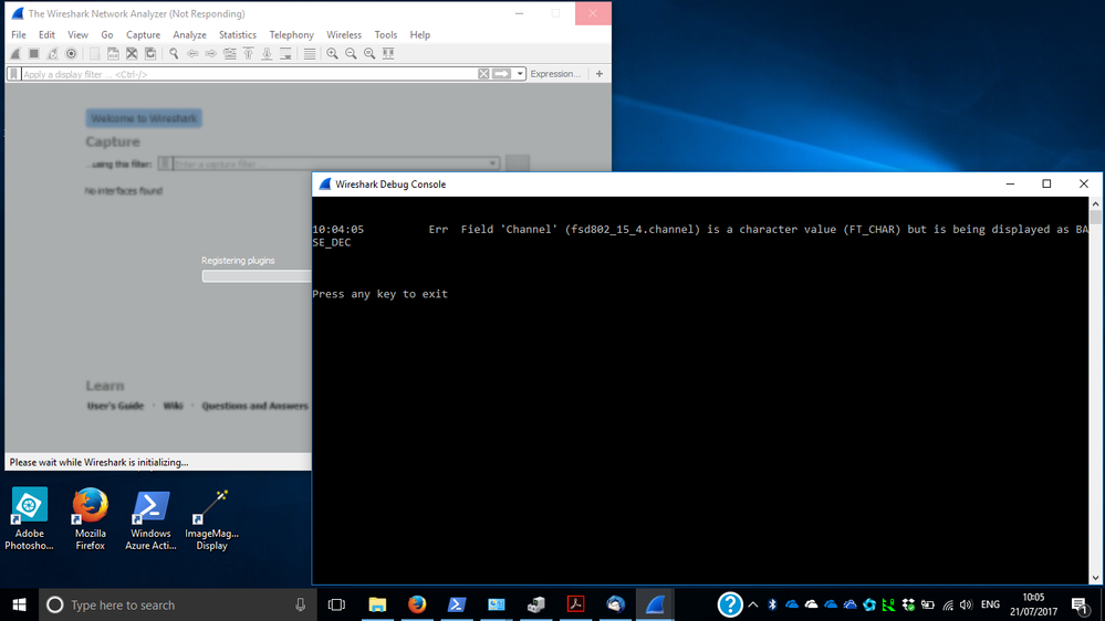

I have been trying to use an USB-KW41Z with Wireshark (v2.4.0-0-g9be0fa500d) and the Kinetis Protocol Analyzer Adapter. However, there appears to be a problem with Wireshark\2.4.0\plugins\fsd802_15_4.dll. Wireshark runs as expected before the Kinetis Protocol Analyzer Adapter is installed. However, after installation a Wireshark Debug Console window pops up with the message Err Field 'Channel' (fsd802_15_4.channel) is a character value (FT_CHAR) but is being displayed as BASE_DEC.
Pressing any key doesn't help.
Is there a fix or work around?

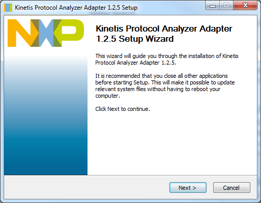

AleGuzman
This problem is that Kinetis Protocol Analyzer v1.2.4 needs to recompile the plugins for Wireshark version 2.4 and above.
To address this issue a new release was uploaded to Kinetis Protocol Analyzer Adapter v1.2.5
I tried it at my Windows 7 64-bit and it works.
