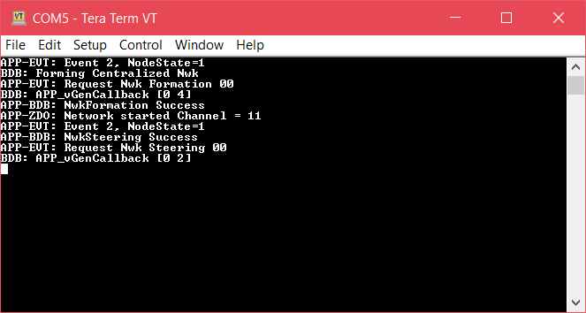

I run the default Coordinator_JN5169_DONGLE.bin on the JN5169 Dongle and send a "form" command and it gets stuck after trying to form a network:
* COORDINATOR RESET *
APP: Entering APP_vSetUpHardware()
APP: Entering APP_vInitResources()
APP: Entering APP_vInitialise()
Initialising UART ...Done
Recovered Application State 0 On Network 0
APP: Entering BDB_vStart()
APP: Entering APP_vMainLoop()
APP-EVT: Event 2, NodeState=1
BDB: Forming Centralized Nwk
APP-EVT: Request Nwk Formation 00

Hi Jonathan, I hope you're doing well!
I was able to compile and successfully start and steer the network.

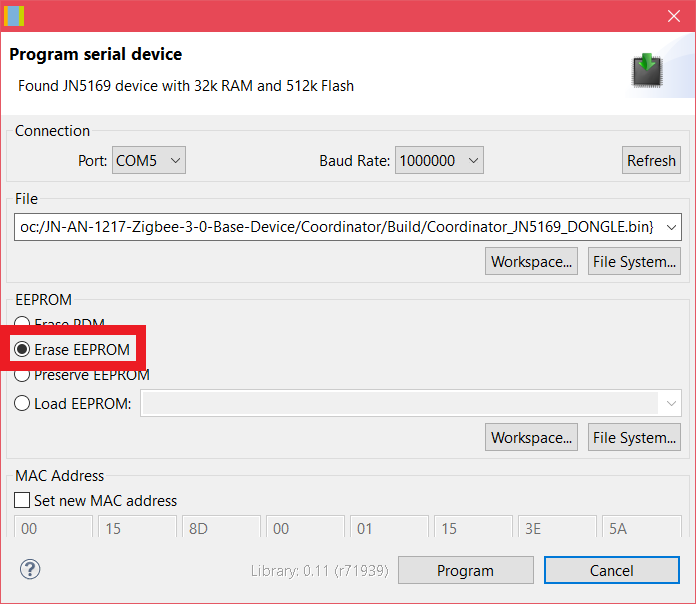

Could you please check that, when programming your device, you are erasing EEPROM?
Please let me know if you have any further issues.
Sebastian

jonw1
Erasing EEPROM worked! Thank you. I am not seeing the GUI you have pictured. The only way I can program is via command line, but when adding the "--eraseeeprom full" option, the examples were able to form and join networks.
